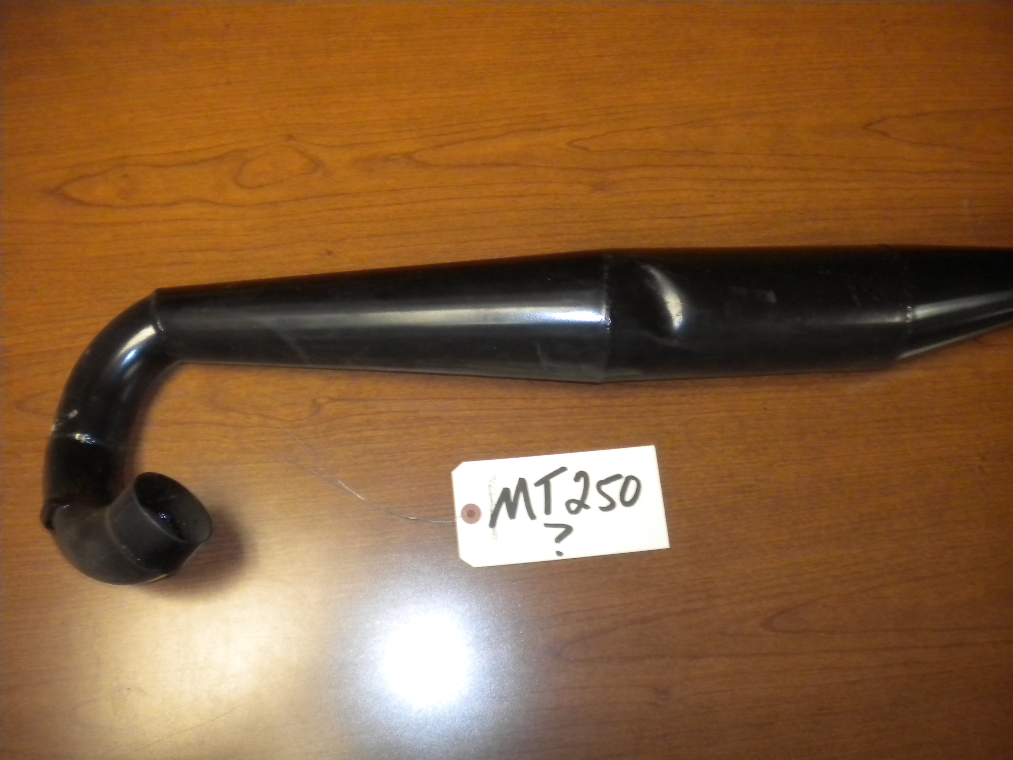

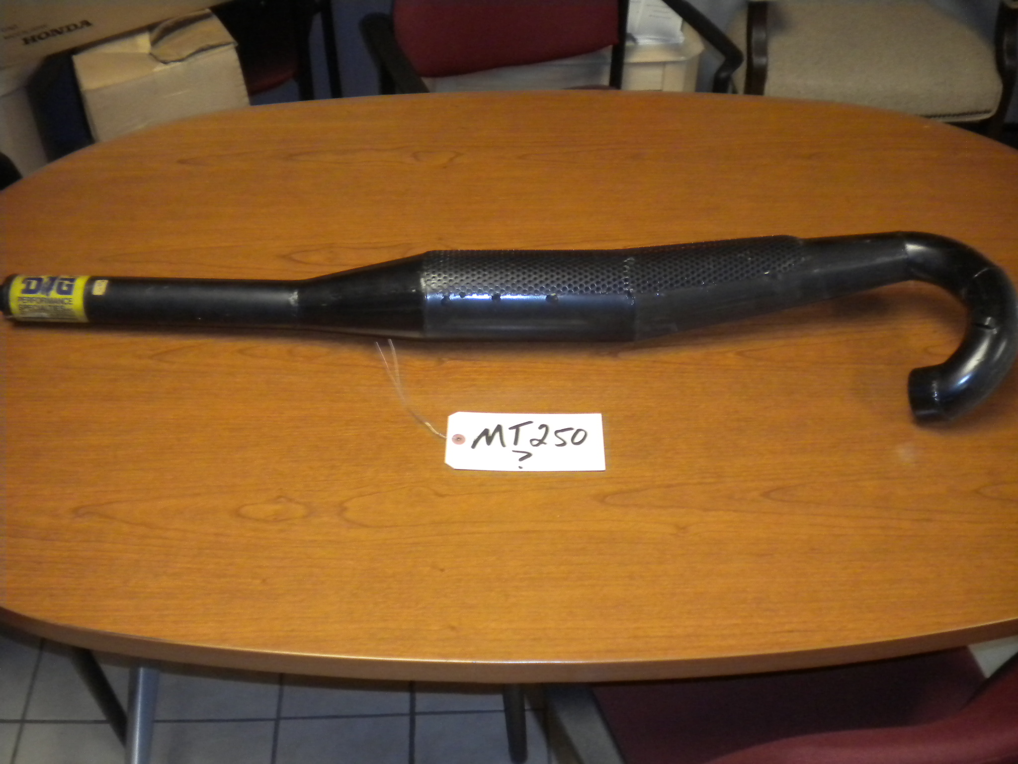

I am pretty sure this is a new DG pipe for a MT250. I have a used cylinder and the header fit in nice. There are no mounting tabs, like on the stock pipe. I would like to list her on E-bay and need to be :? sure of the fitment. Thanking you in advance for your time. Art @ Burgers Honda

B-JOE, Thank you for sending the DG promo sheet. Unfourtunitly there are no numbers at all on the pipes. I did learn that my Mt250 pipe, may be a MR250 pipe :?

Pretty sure it's for an MT rather than an MR as the exhaust exits from the left side of the barrel. The MT exits from the right, same as the 73/74 CR250.

Actually, Art, after studying your pipe further, I'm not sure it is for the MT250.

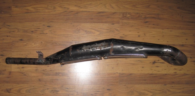

If you look at the picture of my MT250 Torque Engineering pipe, the angle of the stinger/tail pipe appears to be opposite that of your DG pipe?
File comment: Torque Engineering pipe for MT250
As my Torque Engineering pipe doesn't tuck out of the way that well towards the rear of the pipe, I would suspect that this DG pipe would be worse.
Just a thought... I don't have any pictures or articles on this but, I do remember that someone made an up pipe for the 73/74 CR250 and I'm pretty sure that that was DG. Could this be what your pipe is? Might be worth checking out.
Either way, it's definately not for the MR250
Hope this helps,
Grae.
