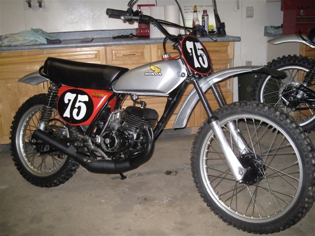

Thanks Ray for the great deal and quick shipping on the Retro Rocket pipe. The pipe is on my bike now. Hopefully the photo that I attempted to attach is visible.
It hangs down a little lower than the stock pipe but not as low as some other pipes and it touches the footpeg mount. Once the weather warms up I'll test it out.

PostPosted: Sun Jan 23, 2011 10:47 am
Mark,
The pipe - and the bike - look great! I think the pipe looks a lot nicer with paint on it.
Does that pipe have a hook down below for the spring that goes to the frame loop below the shifter shaft? If that spring is missing the pipe might move a bit to the right and contact the footpeg mount; just a thought.

Yes that spring is installed. I will have a closer look when I get some time.
