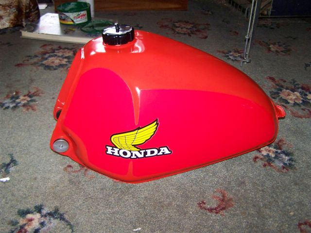

Here are some pics of tank 30 hours of prep tank had quite a few dents ( probably would be more if I rode this for the last 31 years :lol: ) filled, sanded, self etching primer, paint from vmx tahatian red came out pretty good for a rattle can job, then graphics to help protect from knee rubs etc. started the wheels last night hubs will get powder coat black new Excel rims I hope to use the old spokes

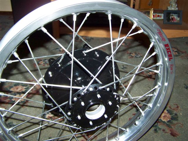

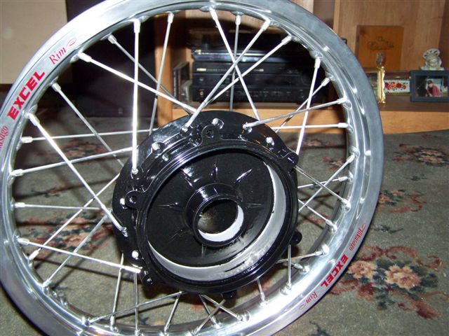

finished rear wheel tonight powder coated hub ( just got powder coat system) , spokes wire wheeled,buffed,zinc plated then polished. I broke 1 spoke with torque wrench. attached are b-4 and after pics
