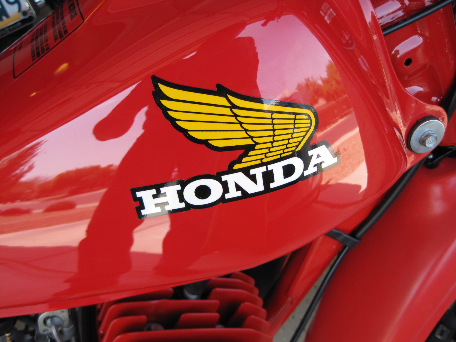

The tank was done by a body shop. It had a softball size dent on the right side that had to be pulled out. We realized our limitations and opted to let the professionals do this part. The painter color matched the spray we had been using. I realize this thing is way too shiny but it looks good to us.
We applied the reproduction decal set we got from vintage factory.
There should be a third warning decal but we left it off because we were unable to find one that said "cr80" in the text. They all say 125 and 250. I can always change them later if we find originals.
