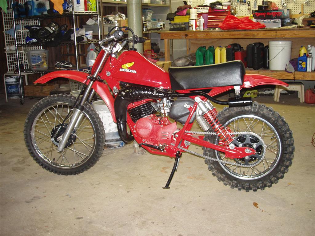

OK--here most recent pics....
Please don't trash me for incorrect cylinder color!! I was leaving the motor alone as it was all original (even still has a new 49.50mm piston in it!) and wanted to leave it all original..So cleaned up all the motor nicely but the cylinder cooling fins had too much baked in red clay and 2-stroke oil to clean off so I had to sandblast it. So I painted it flat black engine paint for now...can go back and redo it when time comes.
ALSo have to re-install the chain guide/roller...paint is drying on it right now...unfortunately it did not get sent to paint shop with frame and tank and other parts when I found it in a wad of paper in the box I had my parts in...so called guy that painted it and we used every drop of paint up! So may try to do it with the Chrysler Industrial Red spray can since it doesnt show much under there and prob look close enough? :( I made a new roller for it out of some Delrin I had laying around and drilled and pressed a bushing into it--will leave chain guide in flat black primer for now and go ahead and install in a few minutes..
Still looking for side panels but that is proving to be either too impossible or too costly--hate to spend the $200 on all new plastics but may have to--despite fact front and rear fender in such good shape!
I also poured a few drops of 25:1 down the spark plug hole and the darn thing started on the second kick and sputtered nicely like an air-cooled 80cc should for a few seconds...
Now to fabricate and airbox lid and find a choke assembly for my carb.
ALso have to stencil the logo on seat yet.
Thanks for all the help! Doug Roberts, Alabama, USA

IT'S ALIVE!!!
Still trying to acquire a choke off eb*y but dropped the old choke plunger in there and plugged it off with a rubber stopper, put some metal tape over the airbox for a temporary cover, and cut an old sponge down to put over the air element til get one.....darn thing started on the second kick and runs like a scalded cat! had to back the airscrew out another near 1/2 turn to clear up the upper RPM's and it ran even betta! will tune carb perfectly once I get the airbox lid fabbed up and a correct choke and airfilter...
All in all very pleased with the performance. Interestingly the entire bottom end is original 1980, as are the cylinder (original bore) and the head.....I just put a new piston and rings in(stock bore) with a very light hone of the cylinder to clean it up....very cool to see/hear a 32 yr old motor run that tight in essentially original condition!!
Anyways will keep trying to locate rest of parts and then run it out good on the road one day to get through all the gears and tune carb perfectly. Really like the little thing though...heard they had heck of a lot of power for an air-cooled 80cc and I agree it definitely delivers a good punch when it comes on the pipe...love to ride one with a hi-compression head and a pipe/carb setup....would be fun....... :D
