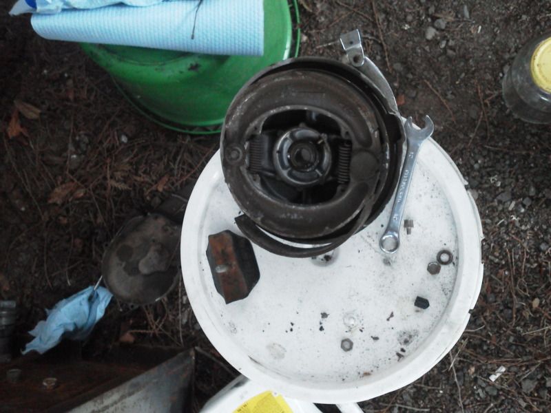

Unfortunately today while I was changing the front rim I found this:
So now I need to wait for new shoes to get back to testing.
