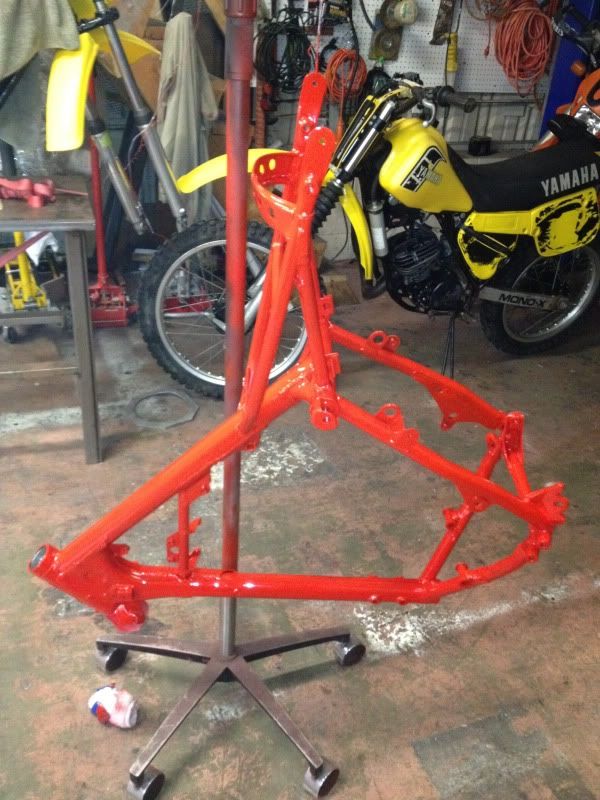

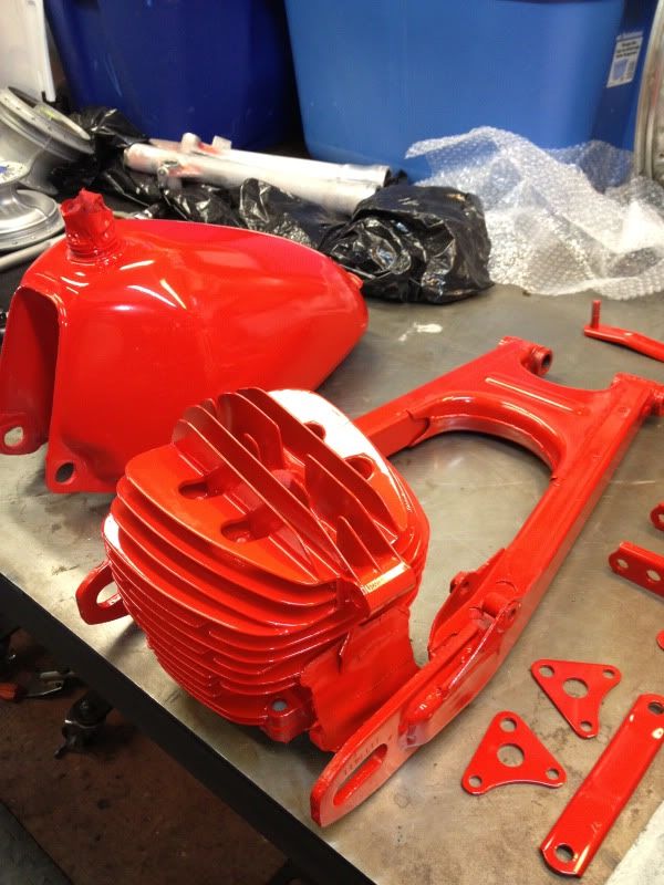

I am in the process of restoring my 79 cr250 went with vmx paint here is what it looks like so far. Paint covers nice.
another project
