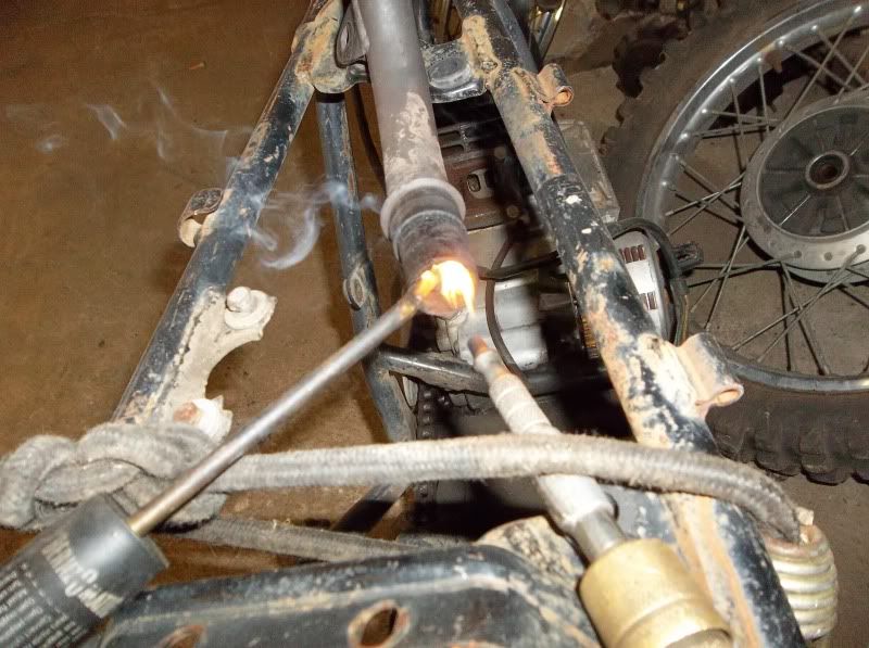

on cleaning out pipes i use a torch or even a strong heat gun can be used.
in this pic i used a Mapp gas torch and some metered compressed air injected into the pipe.
in this pic i am blowing a good amount of air through the pipe,it had a nice fire built inside.

Re the MR175 pipe cleaning - on that pipe I actually just heated up the turbine-core section with a propane torch after removing the baffle, then cleaned out the turbine sections with heavy-duty pipe cleaners I got from a pipe/tobacco smoke shop nearby. I also drilled out the center section 5/8" and opened up the baffle's deflector end a bit.
+1 on Dave's suggestions - there's also one in the 'MT250... 5k RPM' thread. If your pipe is really plugged up, be careful using a heat gun - the heat from mine blew back out the pipe and melted the gun's plastic housing.

On the mr pipe, will a regular propane torch and air compressor blowing air work? I tried the torch along before and didn't get much of a result.

I only used the propane torch on the MR pipe to soften up the carbon inside the spark arrestor, then used the pipe cleaners to actually remove it. To burn out the pipe you really need a much hotter setup like the welding rig.
