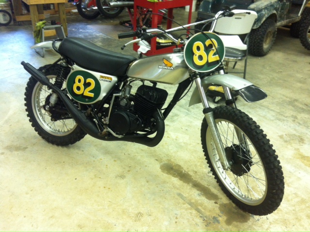

While I'm at it, I figured I'd add an "after" picture. After many hours of detailing. But no repainting. I wanted to leave it as original as I could. The picture probably makes it look better that it really is. It does have it's blemishes, no doubt.

The bike looks great! Sure you don't want to give that head a quick spritz of black paint? The rest of the motor looks so good, it kinda stands out.
It looks like you may have the 36mm carb, which would be stamped '010B' under the idle speed screw. I believe the '73 34mm is stamped 676B, but I could be wrong.

Thanks for your comments, Ray. I may take you up on the advice of spraying the head to match. I agree that it does stand out.
