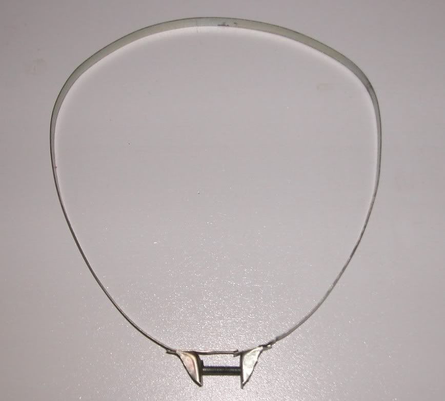

I need to clarify my problem with the airfilter. When I look at the Honda parts diagram, it looks like the filter base plate
and support cage is one piece. Mine is two pieces, a metal base plate and a plastic filter support cage.
Since I am not very good at describing this, as always, I have pictures.
The first pic is the OEM filter base and the ? filter cage. Is this plastic cage the OEM part?
The other pic is the band that holds everything together. I'm assuming it is the correct OEM part.
So I want to know if this is the correct filter cage (I'm guessing not) or do I need to find a replacement if I want to keep
the bike all original.
Thanks.
PostPosted: Fri Apr 25, 2008 7:25 pm
You're doing fine. The black plastic cage is held by several small metal tabs on the gold metal plate and over time the cage warps and it drops out. No sweat, locate it in place and then the OEM filter slips over the cage/plate. There is a rubber edge to the OEM filter which will line up with the outer edge of the gold plate. Put the band in the groove and cinch it down to make a seal. But before all of this insert the carb boot into the hole in the gold plate and seal it in place with silicone.
