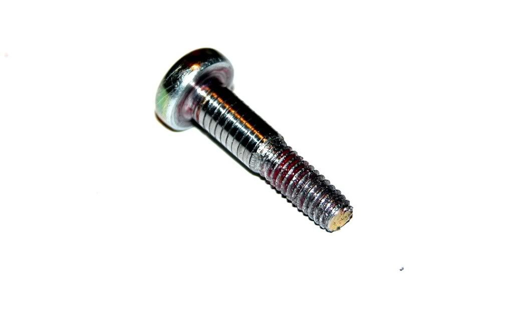

PostPosted: Tue Nov 11, 2008 6:28 pm
Update on the update on the broken screw mess. Since I wasn't able to come up with a stock
replacement screw and I didn't want to spend a bunch on custom made screws, I decided to
make my own.
I started with an OE Honda 5x20 mm pan head and used a 4mm die and a T-handle philips head
to "machine" down the threads. Then I used the round cutouts on my vise to smooth and reduce
the threaded portion to 4.5mm. Below is a pic of the homemade custom.
The replacement screw is the exact same as the original in all dimensions. Total cost, $ .68
The best part is I was able to salvage my "E" ignition cover and remount the stator coils with
a little ingenuity and a lot of determination. Life is good once again.
