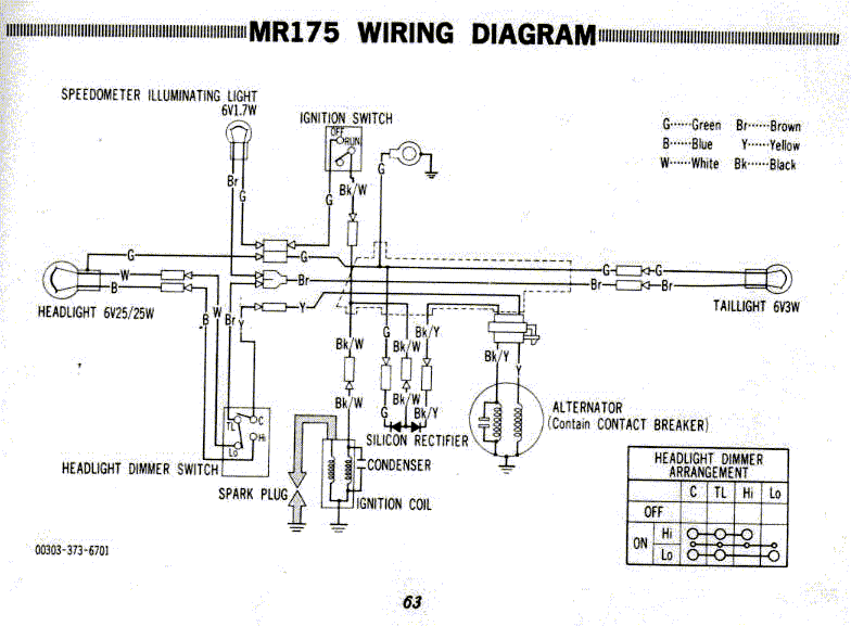

Hey there can someone tell me if their is a link to a basic wiring dig. for a 77 mr175.
 Post subject: Re: wiring dig.?
PostPosted: Mon Dec 29, 2008 9:29 am
This is from the '77 MR175 owner's manual:
Just FYI - the bike runs just fine with the rectifier removed. Just connect the Black/Yellow and Black/White wires together, and leave the Green ground wire disconnected.

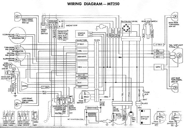

What about a '74 MT250? Anyone have any diagrams?
PostPosted: Wed Dec 31, 2008 3:34 pm
I think this is for all years of MT250:

Wow the MT is a bit more complicated huh?
PostPosted: Wed Dec 31, 2008 3:58 pm
Yes, it really is. ;>)
Are you looking to get your lights etc. working again, or are you just curious why they don't work? I ask because it can be a fair amount of work to troubleshoot an electrical system that was working normally yesterday; one that's been intentionally disabled - as apparently yours has - can be a real nightmare. You really have to assume from the start that every bulb is bad, every switch doesn't work, every wire has been cut, etc. - otherwise you'll probably just end up chasing your tail.
PostPosted: Wed Dec 31, 2008 4:41 pm
Well, it could be so many things. On the diagram, try chasing the wire coming out of the main lighting coil (it's between the YELlow and PINK wires, and is unmarked at that location but may be white with a yellow tracer) all the way to the headlight bulb - anything you encounter along the way could be bad, including the lighting coil itself. Bear in mind that both light switches have to be good for the headlight to work.
This is why I asked about the meter - when a system is in this state of disrepair, it's really easiest to assume the worst and start from scratch. With a meter set to ohms, you could connect one lead to the headlight 'hot' wire and one to ground, and check everything including the lighting coil in about one second, with the motor off. If the lighting coil isn't working, nothing else matters much.
