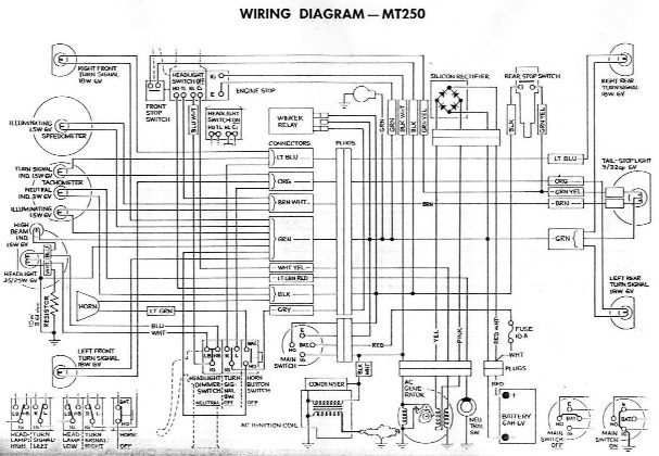

Hello.. new guy here.. I just picked up a 75 mt250. I have wanted one since I was a kid growing up in the 70's and 80's. Well its here, in pretty nice original shape, I am happy with my trade (a 75 CB400f ss project..) bike starts and rides fine except when it warms up (5min..) it shuts off.. I know its electrical, short somewhere. It slowly dies, the I let it sit and it fires and runs fine. Any ideas? Until my manual comes in does anyone have a scan of the electrical diagram?

Here's an MT250 wiring diagram:

Killer!... thanks. I am leaning towards coil. Will post my findings. C

Got it!!!! I had planned on removing all the lights etc.. so I stripped out the harness, wired the coil directly (I am waiting for a proper kill button and resistor..) bike has brilliant blue spark and starts on 1st kick, runs so well, loses power though, its got a fuel delivery problem, gave up for the night and went home. I am waiting on a 2nd dent free tank,and new seat cover, will address fuel issues then. I am very happy to have this bikeImage

This is a familiar stator coil issue. The stator coil is down on the engine cases, at the end of the crankshaft. As the engine heats up, so does this sensitive bundle of wound up wires called the stator coil. As it heats up, the wires expand and cause a certain amount of stress, this can be enough to take it from just within functional to just outside of functional. When the bike is cold, take resistance readings between the combinations of wires at your stator coil plug in. Write down those color combinations and their readings. Hook it all back up and run her until she dies again. Repeat the same tests right away and compare to the cold numbers. My guess is that you will see a short developed during the heating cycle. For a less adventurous method, just heat the stator with a blow dryer until it's nice and warm to the touch to check for the resistance change. Ricky Stator can rewind yours if you can't find a good one.

I removed the harness and it runs fine. took it out for a rip yesterday (despite the temperature, or lack there of..) ran great, I even chatted with my neighbor for 10 mins while it idled and it help a beautiful idle. I figure there was a short somewhere in the harness, kill switch, key switch.. somewhere! I might look at the harness, but I don't plan on using it so I might not.. In short it runs mint.. just bogs under throttle, I think its a fuel delivery issue, I have a dent free tank coming, will address it then. The best think about the bike is I was showing it off to a friend of mine and slowly kicking it over to prime it, it fired right up on the first kick (well not even a kick just a half lever push..) remarkable, I've never had a bike start that easy.
