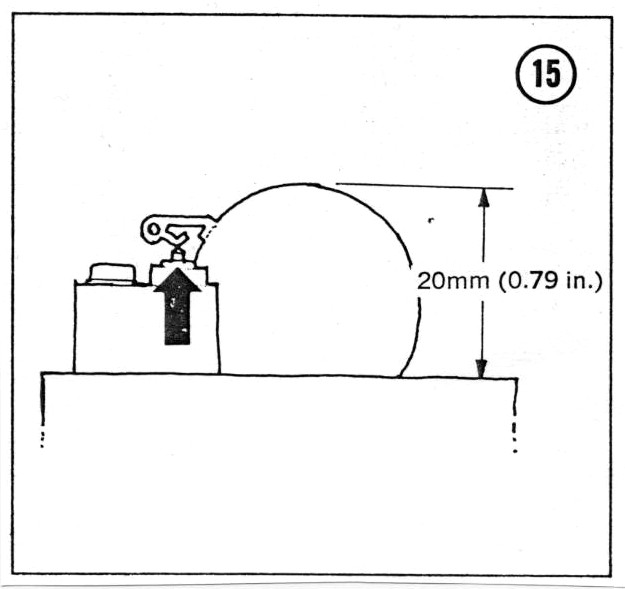

2) I have moderate leaking on the overflows from the carb. I believe this is the float setting correct me if I am wrong and if I am correct can someone tell me how to set it please.

Problem #2-it does sound like the fuel level in the bowl is too high. If you are seeing gas come out of the overflow,that is a definite indicator. How did the fuel inlet valve look when you rebuilt the carb? -that's the little piece that the float tab moves up and down to let gas into the bowl. If it is worn,it may not be stopping the flow of gas even if the floats are at the correct level. Adjusting the float level is not difficult. Invest in a repair manual for the exact procedure. The "bogging" you are experiencing at high RPM's may be caused by too much gas being fed into the engine because of the elevated level in the bowl..I could be wrong though.

I definitely agree that the float level should be checked, especially since you're getting gas overflow. I would also add that once you get it set properly, do not change it again. I almost had to throw away 3 months of jetting work when I re-set my float level; luckily I was able to set it back again easily. The level of gas in the float bowl makes a real difference in how easily fuel can be pulled though the jets, which in turn makes a real difference when jetting the bike. The correct setting is 20mm from the far end of the float to the float bowl gasket surface (I can scan a diagram if you need it).

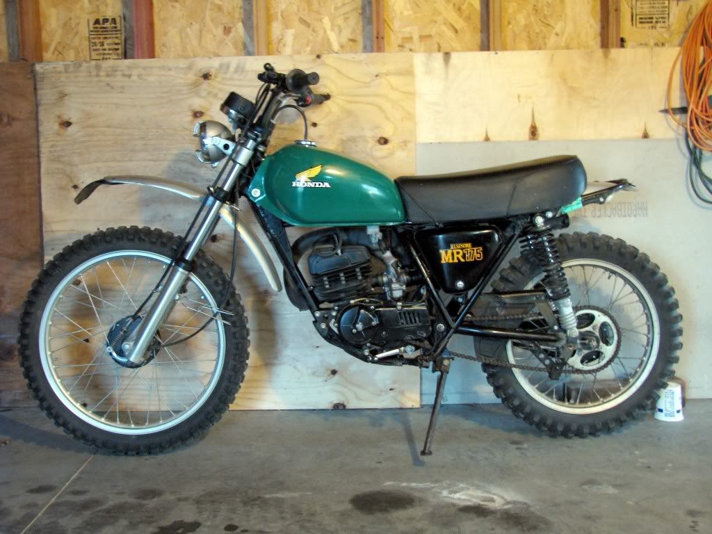

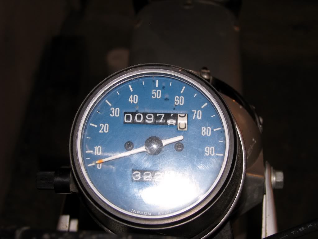

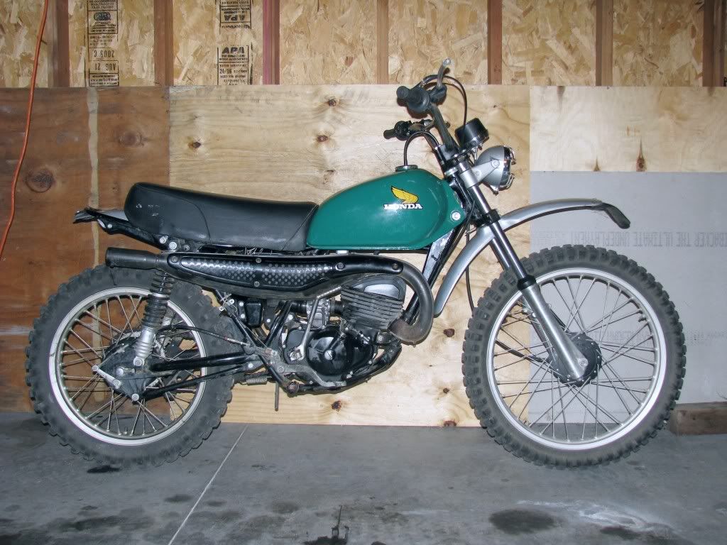

As promised here are the unretouched pictures of the bike. It just lwas just a little dirtier than shown when I got it.

The bike looks great! It's especially nice to see such a clean-looking tank, so many of them are dented up and rusted out.
The float level diagram is below.
