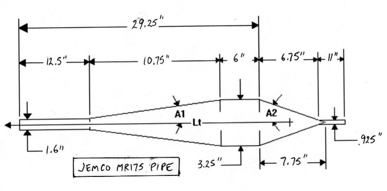

Here's the dimensions of the Jemco MR175 pipe:
The Hooker pipe is kind of like a sardine can with tubes, it doesn't really translate to cylindrical/conical shapes.
