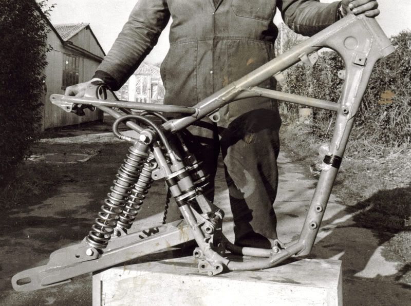

Something I forgot to mention,back in 79 I had a 79 CR125 here in the UK, there was a publication (motocross action I think) giving instructions on how to convert to a 21" front wheel by cut and shutting the top tube to alter the rake to suit.
Back then my Dad made the required jig and carried out that convertion on my bike after which he swopped the jig for some tyres with a local frame builder this guy then carried out these conversions for other 79 CR125 owners.
The irony is is that this bike has had that conversion and as I know of no other person doing that conversion in the UK I can only assume at one point it was on my late fathers jig.
Unfortunatly this one isn't my old bike.
Thought some of you may find that interesting.

Here you go, this is a photo from when your frame was converted 30 years ago, i'm 100% certain its the one because it was the only one which had the swing arm modified too, those shocks had come off my 78 Maico. :D

Where did you find that bike? I'm pretty sure i had that about 14 years ago but sold it when i cleared out all my 125's. The missing bits would have gone on my 1980's. :D
