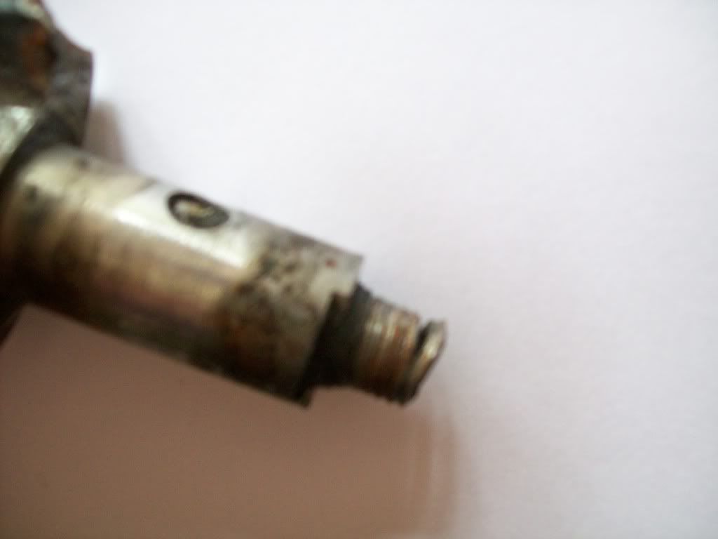

does anyone know where i could get a kick start lever?? the thread on the end of mine is torn half way off, and stripped :? srry the pic is kinda blurry :(

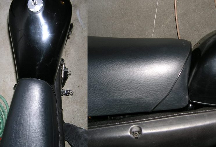

I use the Clarke 1362X tank, which holds almost 3 gallons and mates up well with the MR seat. A CR tank will look really skinny, and may not be long enough either.
