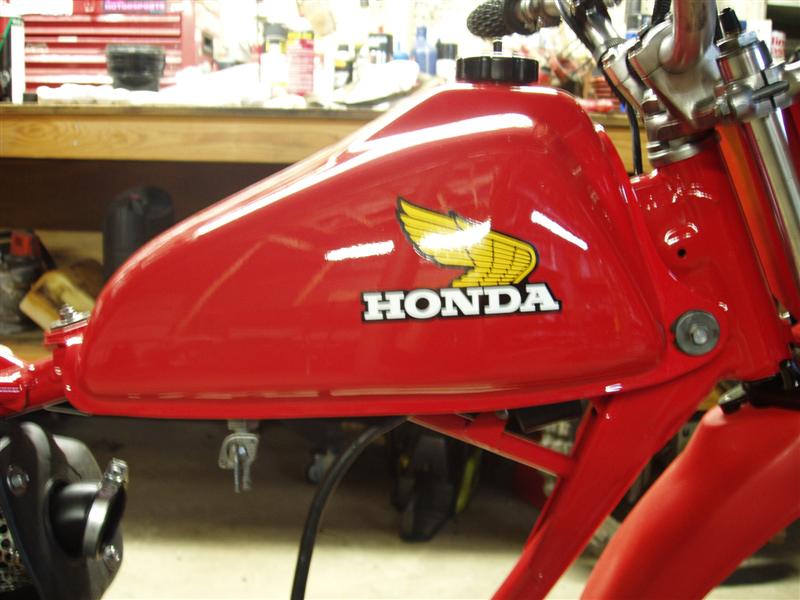

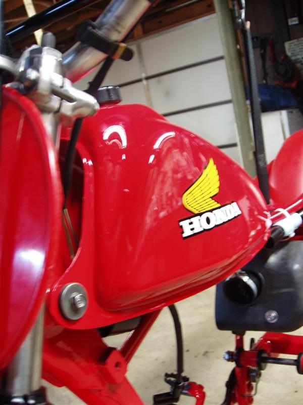

In the close up picture that shows your frame tag on the head tube, where did you get those trick mounting bolts/washers for the gas tank? They look like the same ones used on the Mugen and Works bikes.

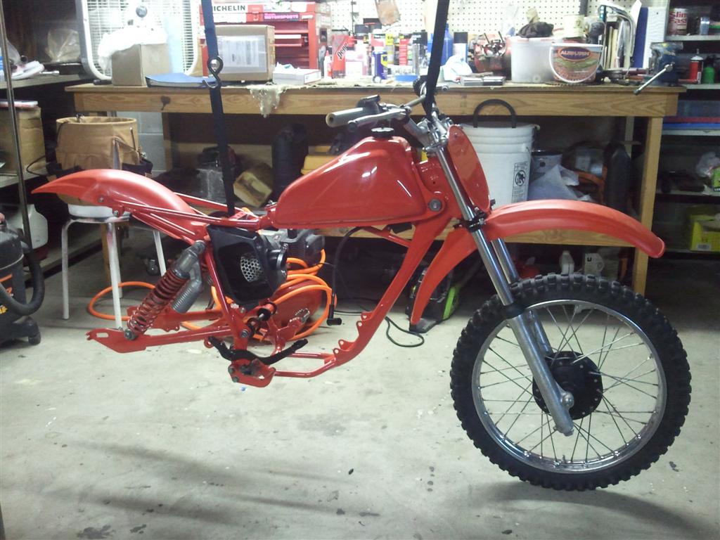

Progress continues to be made on the CR80. Got front tire cleaned up nicely and re-tubed. Rear tire appears tobe holding air for now. Unfortnately have a broken spoke... :? Still not sure why all the spokes have a little wire twisted around them where they cross on rear rim....anybody got a clue? I have done this with a single broken spoke before temporarily but not to ALL of them?
Still waiting on chain and sprockets--new Wiseco first overbore piston came yesterday. Need to come up with new rear axle--old one was messed up pretty badly and corroded in place so i finished damaging it...oh, well a little carnage is expected.
ALso ordered new tank and side plastic decals from Vintage Factory last night. They should look good on the tank. Removed seat coverand going to have a friend who is real handy with vinyl and sewing machine use it as a pattern to make a new one for me--might have him make a couple while he is at it. Then will make a stencil to do the "Honda" and the "CR80" gaphics on the side with white and red vinyl dyes...
Need airbox cover yet...?
Anyways here is most recent pic. Enjoy--Doug
i made them by myself, at work we have a lathe and a milling machine.

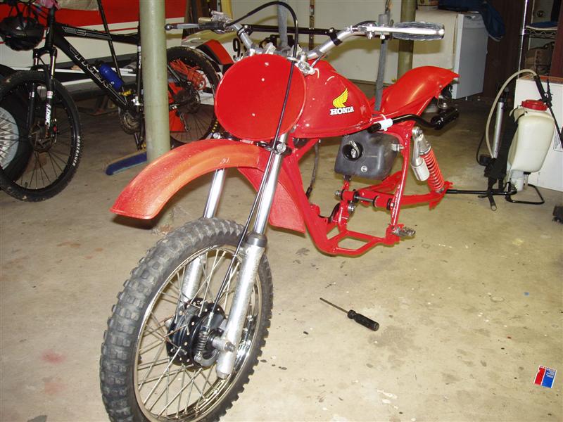

Here is pic tonight of tank graphics and front wheel/new brakes/brake cable installed.
Also got rear rim un-laced and cleaned up. Will repaint hub this week while waiting on new spokes--turned out only needed one inner spoke and one outer spoke--all 36 of the nipples were still good and reusaeable as were the other 34 spokes...will re-lace spokes, new tube and remount tire and finally have a roller...

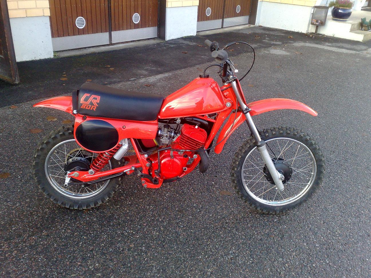

If you need new seat cover----> http://mxm.co.uk/

I am having a seat cover made from matching vinyl by a friend who took old one apart to use as a pattern then I have made a stencil to dye the CR80 logo on the side--I think it will come out nicely--thanks for the tip on www.mxm though.
