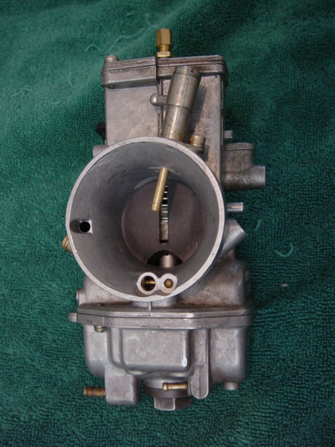

I have this 38mm carb off of a CR powered shifter Kart.
