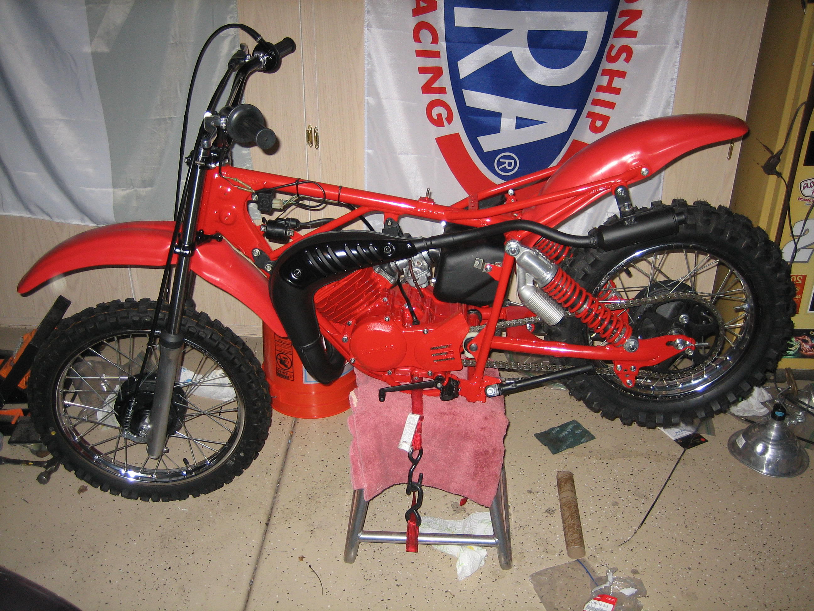

We removed the spokes from the front wheel and polished them one by one. We replaced a couple that were missing. Spokes have to be the worst part of this job. It seems like it never ends. We took a good sized dent out of the wheel and gave it a good polish. The hub was painted flat black then we relaced the wheel.
The front brakes and tire were in good shape so we re-used them.
We painted the kickstand, foot pegs and kickstart lever with flat black. I'm sure the paint wont last long but it looks good right now!

This picture shows a lot of the little things. The clutch and brake levers are aftermarket but seem very close to the originals that had been shortened on the bike. The throttle and brake cables are NOS Honda. The clutch cable had to be aftermarket.
We capped it off with a NOS set of grips that really make it look original.
The shift lever was installed and the wiring was reinstalled also. It's just hanging on there with zip ties now but I have a handfull of the metal, rubber coated bands from an old Honda Sabre to replace them with before the tank goes back on.

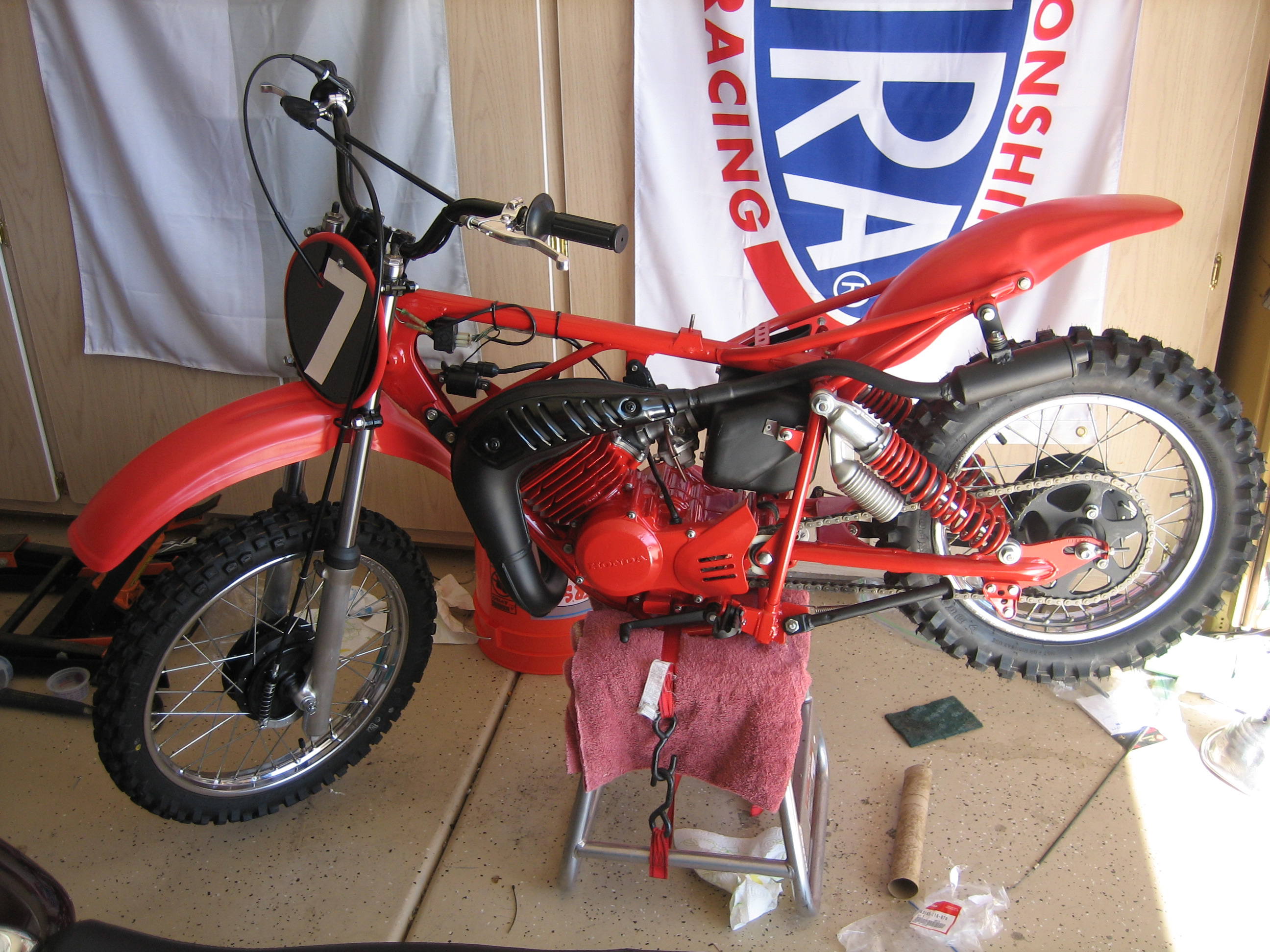

The DC plastics kit came with a number plate that is way too big. We removed the standard attachment pieces and drilled a hole in the plate for the throttle cable to make it look more authentic. I'm keeping my eye out for an original plate. What's the best way to recondition one?
We installed the black background and the number 7 that was on the original bike. I still need to get some vintage numbers. These look too modern.

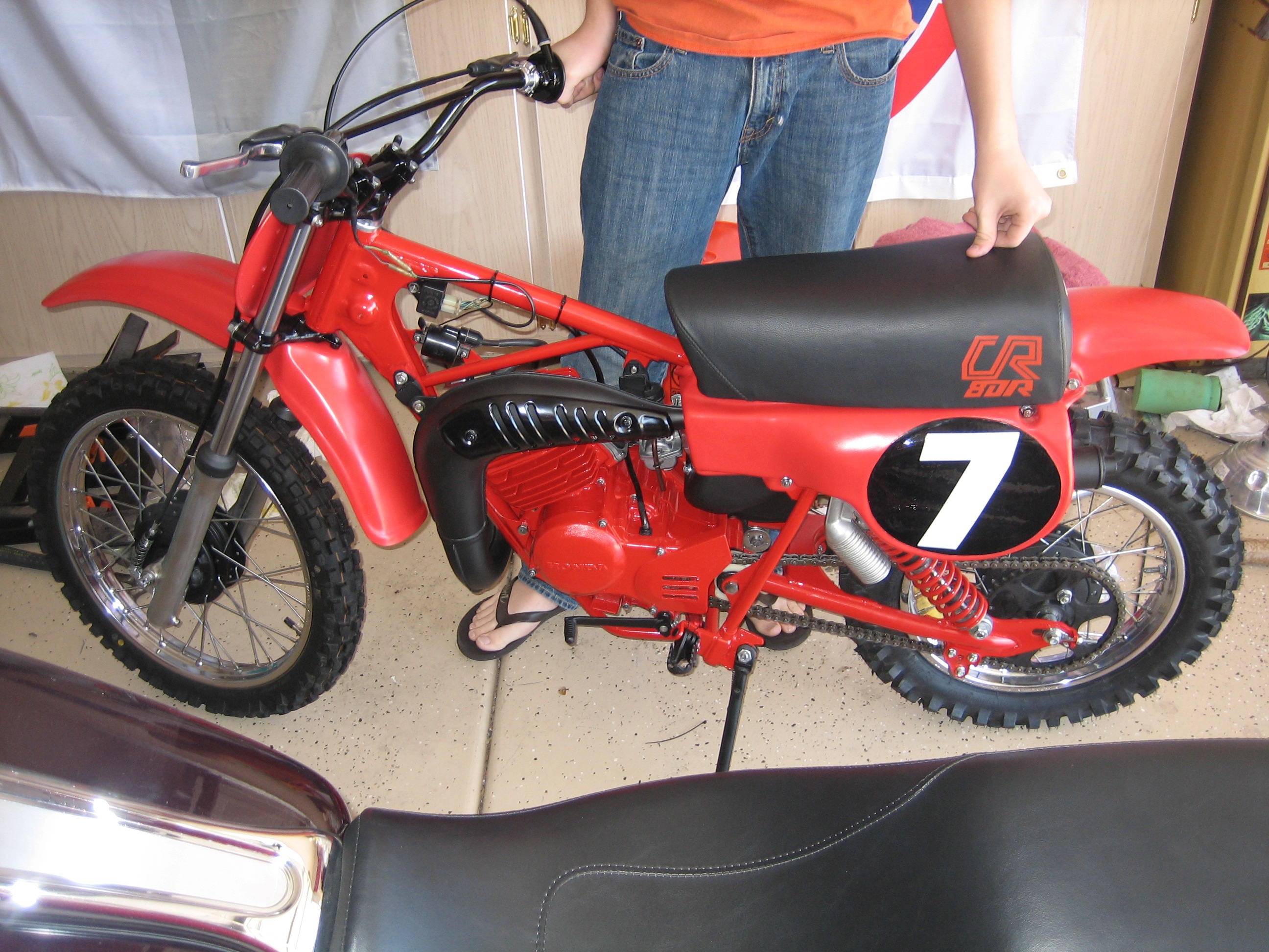

The seat was recovered and stencil painted. Looks like new. The side plates went right on.
I realize the tank should have gone on first but it was out at the body shop and we just felt like putting them on.

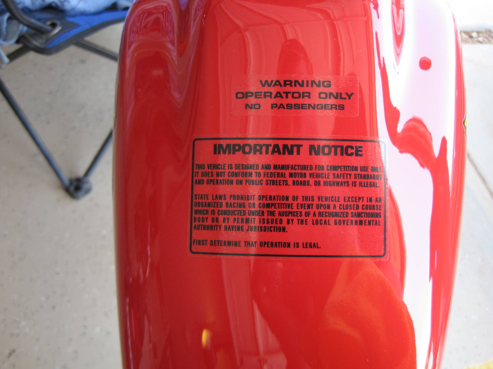

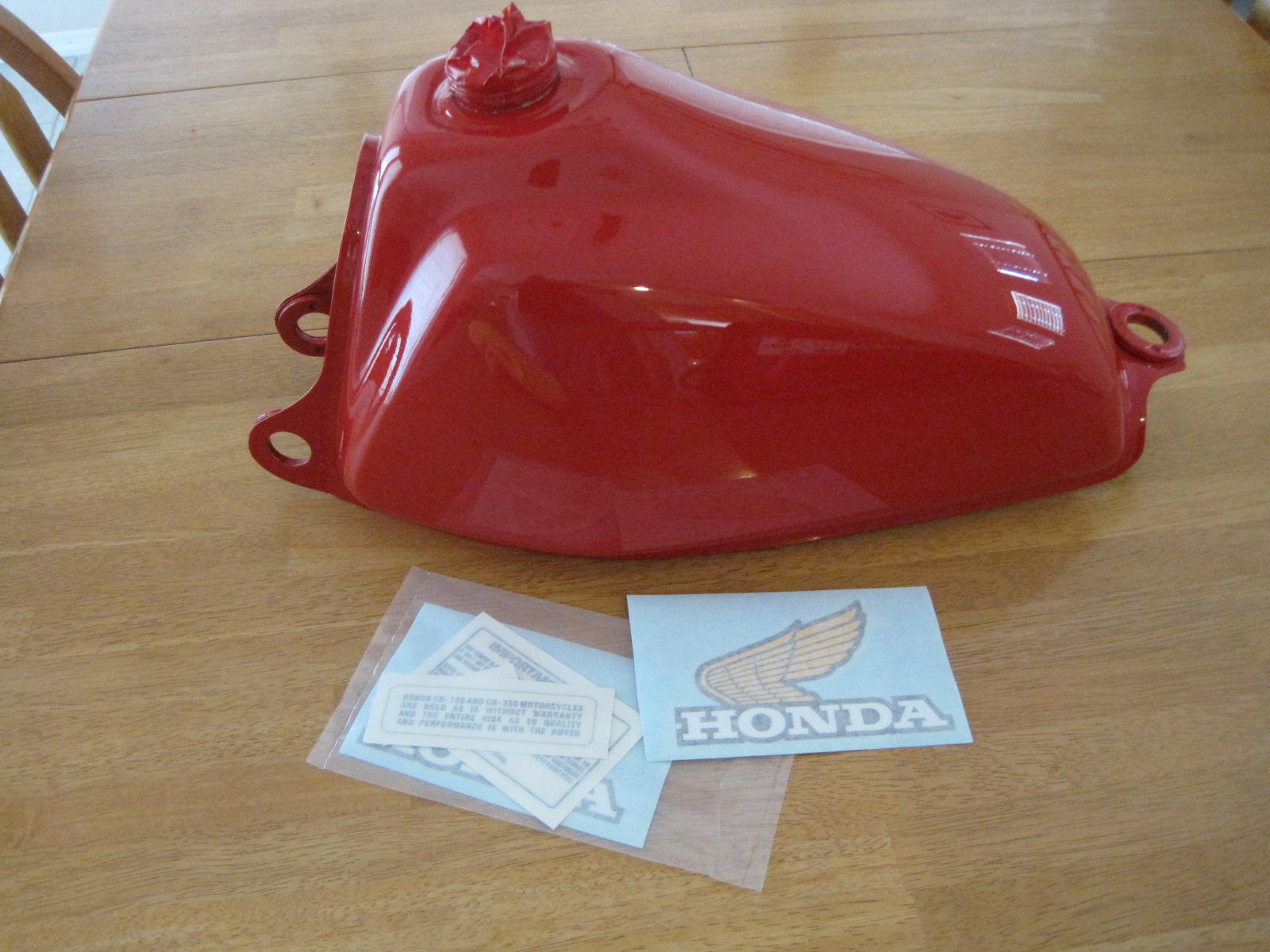

The tank was done by a body shop. It had a softball size dent on the right side that had to be pulled out. We realized our limitations and opted to let the professionals do this part. The painter color matched the spray we had been using. I realize this thing is way too shiny but it looks good to us.
We applied the reproduction decal set we got from vintage factory.
There should be a third warning decal but we left it off because we were unable to find one that said "cr80" in the text. They all say 125 and 250. I can always change them later if we find originals.

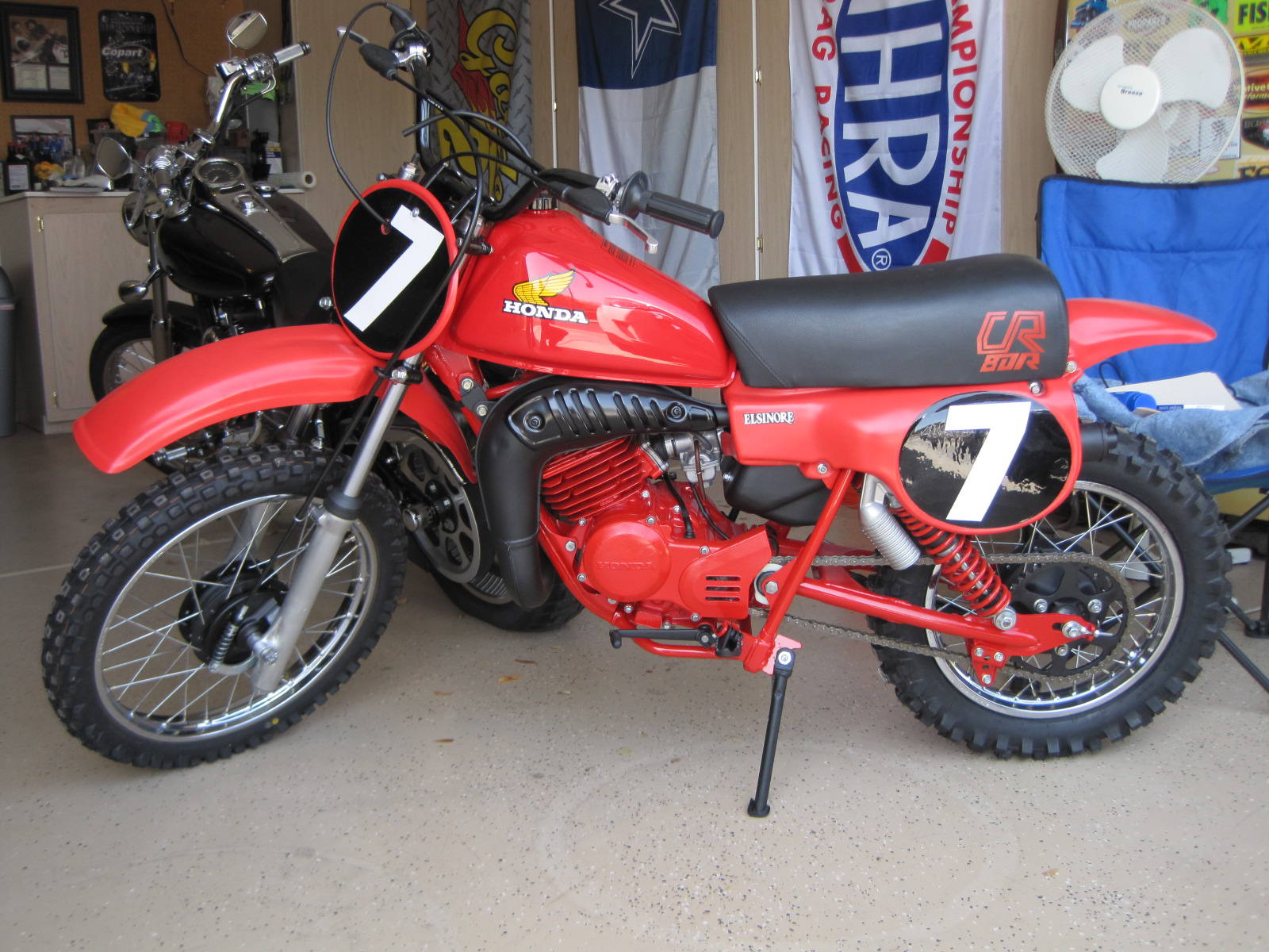

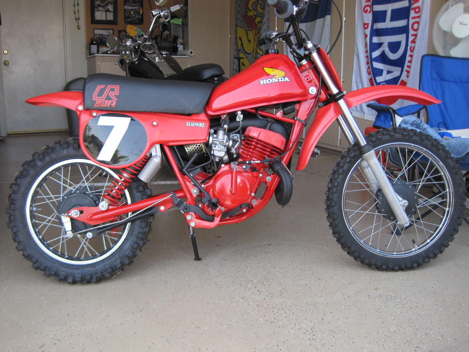

So here's our mostly finished product. Just a few loose ends to tie up now. Still need to get the air cleaner on there and start the thing. I'm giving the paint another week to cure before we let fuel get near it.
It's really been a fun project. I appreciate you taking the time to keep up with what we've been up to. I've got a piece of my childhood back and my son has a better understanding of how motorcycles work. If we can be of help to anyone else in their restoration, please ask.
Brian & Michael
