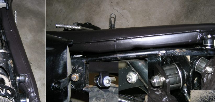

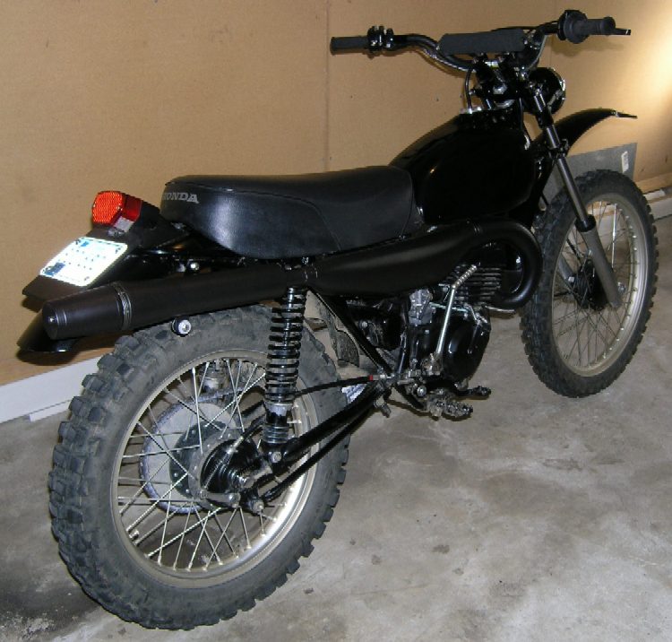

PostPosted: Fri Oct 28, 2011 7:51 pm
Jon,
OK, second try ...
Here's the entire exhaust on the bike:
... and here's a composite of the pipe's fit to the frame (left and top) and the various mounts (bottom right):
The mounting is pretty solid even without a center mount; there's no way the pipe can twist or droop unless something breaks. It really can't be tucked in any tighter without hitting something, either.
