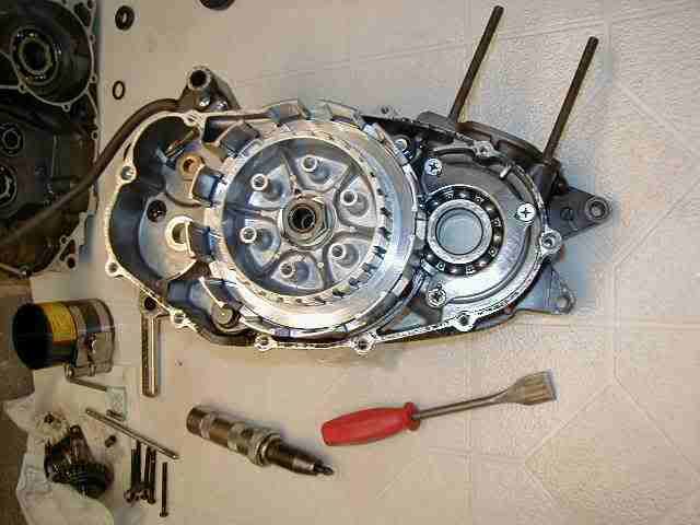

7) Buy some chemical gasket remover and an aluminum tool so you don’t scratch the surface. Notice how clean mine are in the picture.

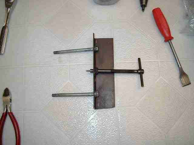

Here is a picture of the case splitter that I made from and old piece of angle iron with a nut tacked on. The threaded shaft was from a pulley remover. Also shows the gasket removal tool.

Jake I made the same tool years ago when my 74 cr was 2 yrs old, I had bent a shift fork and I think in the original owners manual they must have shown a picture of this tool, as I don't think I came up with it myself. I never use sealer on my gaskets and have in fact used grease on them if I know I will have to take it apart again. I beleve the reason Honda does not mention sealers is that they dont use them. I've put together alot of 4 stroke z50 and ct70 motors and have never had a leaker. Too many times people use too much sealer on these ohc engines and clog up the small oil passages that feed the camshaft, wrecking the head and valve train.Not a problem on these motors tho, but your better off making sure your gasket surfaces are super clean.I use a single edge razor blade to clean mine.When you go to put the crank into the case, I have had good results warming the cases 1st and the crank will drop right in. And if you round out the head of a phillips head screw in the case, I just get a drill bit that is about the same size or a little larger than the screw and drill off the head . Then when you get the cases apart you can grab on to what is left with a vice grip and they come right out. I think that as you hit the impact driver with the hammer it must bind the head on the case plus the fact that the screw is still under tension the head then strips.On one of my last motors I just drilled them all out rather than mess with them. Good luck Gary

Steps to a rebuild would be a great topic. I started looking through some more of my pictures and I noticed that it is in fact a bolt that holds the gear on, not a nut. I will have to correct my earlier post. If my memory serves me right you should be able to rotate the basket and the gear will come off. Maybe you have to pull out the crank at the same time if there isn't clearance. And yes, you can split the case with the gear on. I would remove the bolt first. Let me know.
Here’s the proof.
