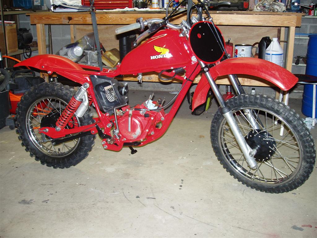

Here is most recent pic of the CR80--
Got the bottom end of motor cleaned up and put back in frame, drive sprocket on--as well as front number plate holed for throttle cable and the number background on. I heated a piece of 3/4" copper pipe with a propane torch and melted a perfect hole in it in OEM position--worked better than drilling the hole for the throttle cable.
Still waiting on the seat cover from my buddy who is fabbing it.
Also got kickstand straightened, rethreaded and reinstalled with new shoulder bolt. Need to find a 4" pull spring for it now and the bike can come off the sling finally.
Also realized I had not painted the rear chain roller assembly when had rest of bike painted--it supposed to be Tahitian Red like rest of bike--it small and inconspicuous enough I may be able to cheat with a spray can of Chrysler Ind. Red and no one but me ever know. Probably going to do that with the springs also as they look bad relative to rest of bike now....they not clean up as well as I though once rest of bike was sprayed....
The head is degreased and cleaned and looks good, and it as well as the cylinder --they are actually in my dishwasher right now!!! gets all the grease and oil out of the hard to reach cracks and crevices....
Here is newest pic--will keep posted on progress--got sidetracked by a 1987 KD80 project that I picked up and got running after sitting 20 yrs and ran Saturday then quit then ran then quit then ran and finally quit again....?!?!?
OH well....still need a pic of air box when the snow melts b-joe....btw it snowed yest and today here in Alabama----highly unusual....DOUG

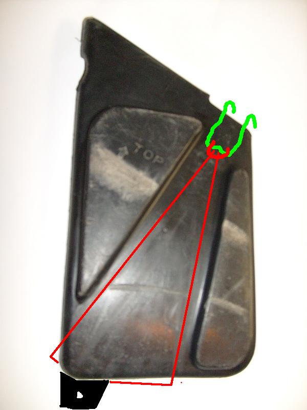

Any chance of getting a pic of that airbox cover yet or you still snowed in? If possible would like a pic from top, side and front of it off of the airbox...thanks
PostPosted: Thu Jan 20, 2011 11:42 am
i will do it this weekend.

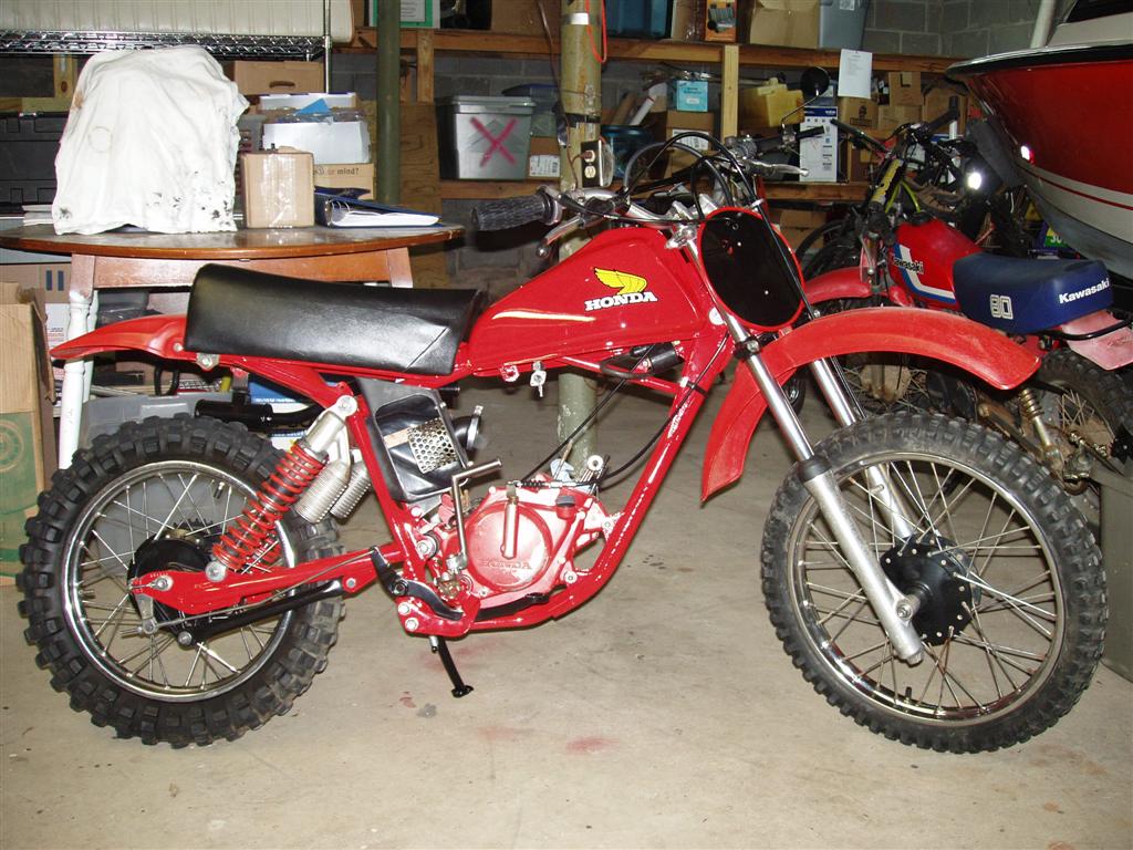

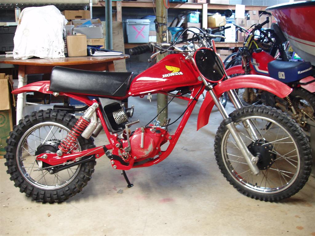

PostPosted: Sat Jan 22, 2011 6:38 pm
Posts: 64
OK--seat is on, I think it looks good--big thanks to my buddy Rob for his stich wizardry--
ALso put the throttle cable on and installed throttle assembly and hand-grips.
Gettin' there..... D
PS-added a pic with and without flash--not sure which shows better.

PostPosted: Wed Jan 26, 2011 4:29 pm
ok?
PostPosted: Thu Jan 27, 2011 8:41 am
Posts: 64
Thanks a million b-joe--am going to to try to fab up one of those with some black gutter plastic or something similar.....
What holds it on--a sort of elastic/rubber band type loop? My Honda manual shows only vague illustrations OR distant blurry pics of it installed. D
PostPosted: Thu Jan 27, 2011 11:02 am
at my manual it is shown at Fig. III-94 and Fig. III-95.
it is a rubber o-ring and a steelwire hook.
PostPosted: Thu Feb 17, 2011 11:32 pm
Posts: 64
Thank you--that looks simple enought to make--will get started soon. DOUG
