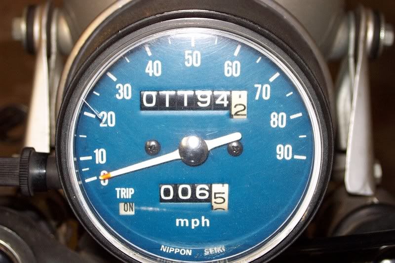

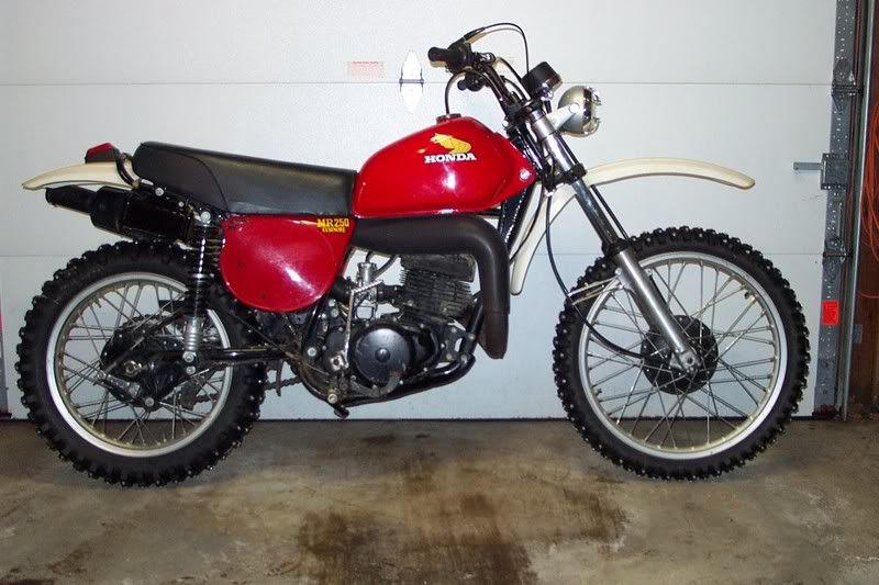

I'm sitting here with the December 1975 Motorcyclist magazine, and it states "on the dyno low 20's".It also says "they made a damn fine playbike,but if they expect to go out and play with the good ol boys, Husky and Penton, Honda will have to make some changes.It is simply impossible to find fault with the rest of the bike.Handling,suspension,riding comfort are as nearly perfect as anyone is likely to get.Only the power,or the lack of it,bothered us.Dyno tests on a CR250M1 show as much as a 6hp gain by removing the bolt on muffler and rejetting.The MR is a different bag where removing the muffler-spark/arrester would not appreciably help.Our test MR250 ran clean and smooth throught the throttle range so we didn't suspect improper jetting as the cause of the bike being down on hp". Bottom line is it's not a CR,but I think you could make a nice bike by combining the two,Honda tho decided it must have not been worth it and cancelled it instead. By the way, here are some pictures of mine so you can see I'm not riding some claped out piece of sh*t
http://i94.photobucket.com/albums/l119/ ... p_0699.jpg
http://i94.photobucket.com/albums/l119/ ... p_0698.jpg
http://i94.photobucket.com/albums/l119/ ... p_0702.jpg

Good lookin' bike!! Maybe my High Zoot 0.040 over piston gives me an extra 5 HP !! I would guess mine is putting out mid 20s, but obviously it is only a guess and a biased one at that. It was scary strong Wednesday, but maybe part of that was an unfamiliar track coupled with the MR's suspension. I can actually tell when it is time for a fresh top end by two things: 1) a noticeable (but not dramatic) drop in power and 2) three or more kicks to start it instead of one or two. Another thing I finally did was just to give up on jetting it for 32:1 or 40:1 and went kicking and screaming back to what Honda recommended 31 years ago. It doesn't smoke more than the less-oil mixes and actually runs crisper. But it does cost twice as much in oil and my friends all roll their eyes at me for not accepting their "science of modern oils" lectures. How is yours jetted? I went down to 42 on pilot and really need a 40 in warm weather. I experimented with the main and went back to stock 110 with clip on notch from top. Never tried changing the power jet. Any chance you'd sell a copy of that article?? I've bid on that magazine a couple of times on F-Bay and always lose.
