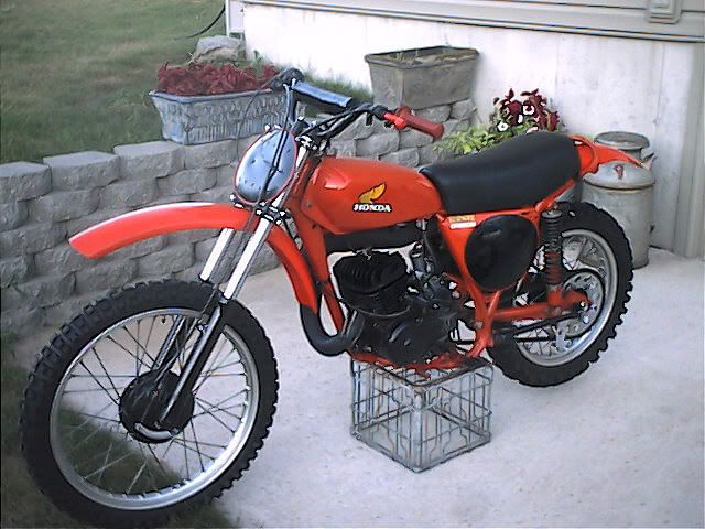

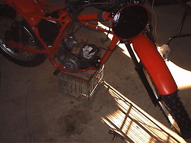

Here's the bike in it's sorry state of disassembly. :cry:
