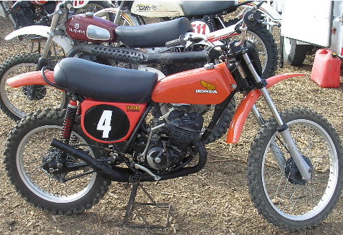

Here's my current incarnation of the 75 Elsinore. The 125 ignition really helps, as you already know! I adapted a 125 Elsinore pipe, which gives the engine much more punch, but the 175 just peaks at a lower rpm. (I did have to lengthen it to make it fit) I think the intake on the 175 is somewhat restrictive, as are the intake ports, but I have not touched them yet. If I get really ambitious, I'll try to mill an aluminum intake to accept a standard mikuni flange mount with a bigger mikuni. For now, my sons already beating me quite handily on it, so there's not much incentive on my part to make it faster. I did add 81 XR200 shocks, which give about 6 inches travel.
I don't know of anyone who would do porting on a 175 motor for you.
Thx
Hans
