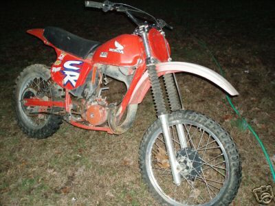

hello! I am new in the forum and just buy a 78 elsinore 250 with broken rod and not very good condition but i think is very good base for my restoration projet.The bigest problem is that i am in Spain and i have to arrange the shiping ,the bike is in philadelphia PA .I am plannig to fly there and making it parts to get it in boxes.
Are the bolts and nuts inches or metric sistem? Is there any body around Philadelphia who wants to help me?
The guy who sold me the bike gave me two weeks to pick up the bike .Any sugestion?
I´m crazy to beging the projet,that seems to be easier with this great forum.Sorry for my english.Thanking you in advance :Daniel
