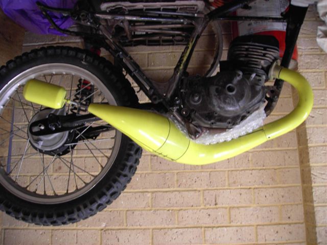

I have a Big bore CR125M 1974, 180cc bored and stroked bike, i am currently looking into building down pipes.
I believe it will suit those of you who have MR175 Motors in CR125Ms
I intend to build Two types of O.M.E look a like pipes with removeable mufflers, the torquer pipe will peak at 7000rpm and the Power pipe at 8500rpm.
Basically i am gauging the market. if i get a reasonable amount of interest, the jobs on.
Regards 1dv8elsinore
File comment: power pipe peaking @ 8500rpm
File comment: torquer pipe peaking @ 7500rpm
File comment: Basic shape of the pipe will be pressed from sheet steel.

It's great to see people supporting these bikes. Thanks for your efforts. I hope you get a good response.
For my own situation, I just sent my MR 175 head and cylinder out for high performance mods and will wait until after I try them with my stock 76 CR125 pipe before comitting to one of your pipes.
Can you tell us more about this big bore engine and what piston, rod and crank you are using?
PostPosted: Tue Mar 11, 2008 2:05 pm
doesn't the cr125 and mr 175 have the same stroke?
