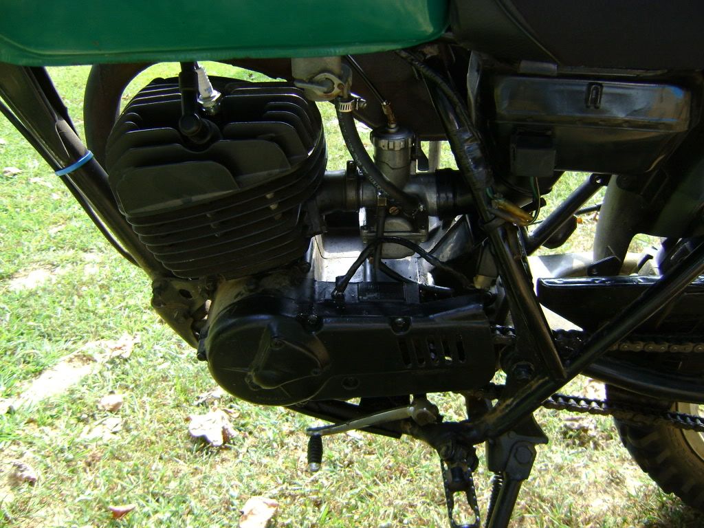

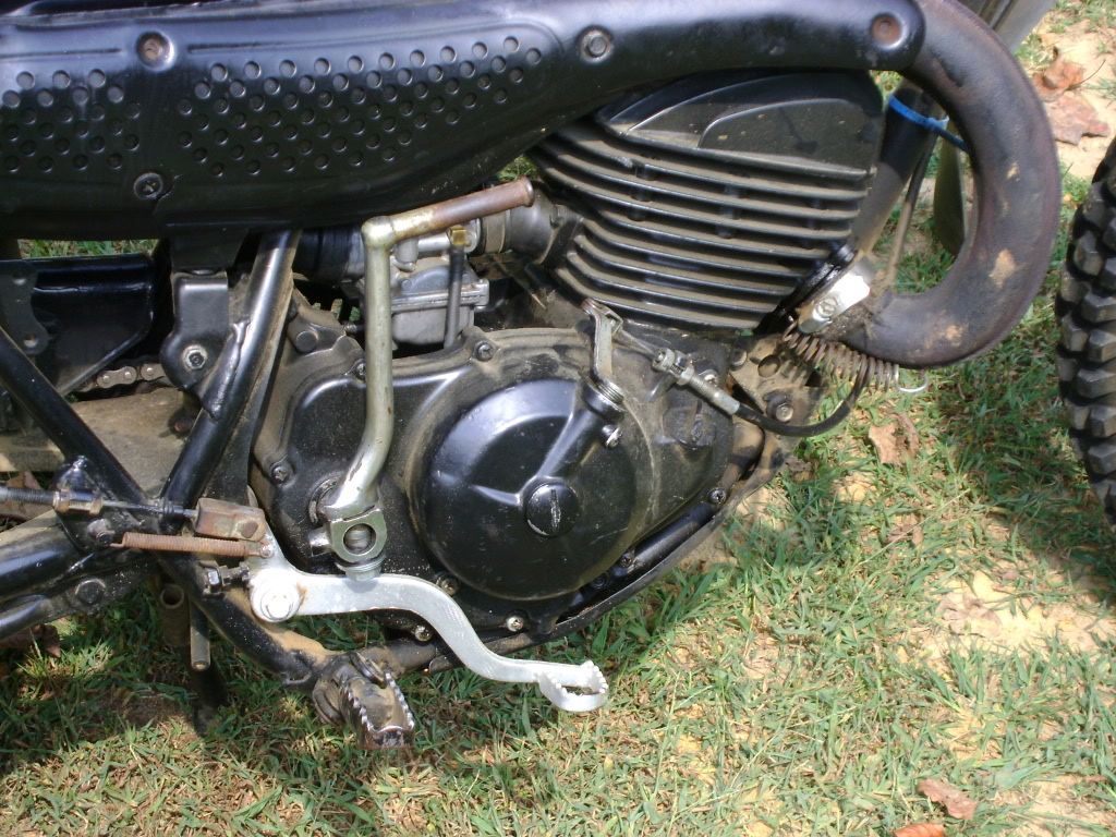

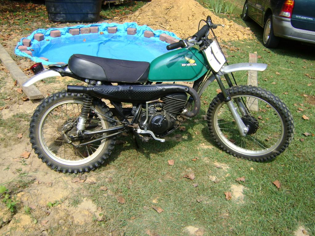

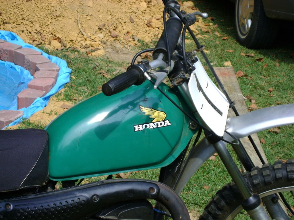

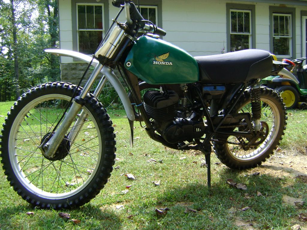

well i belive my floats were stickin so fixin that. oh btw hers some pics :D
