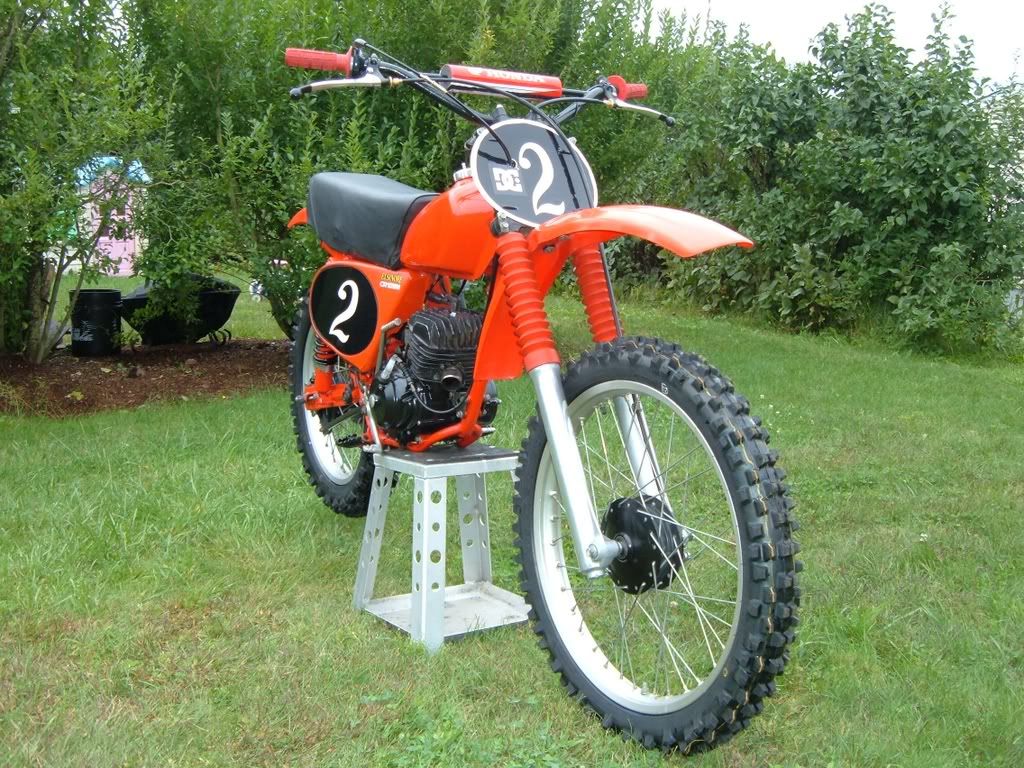

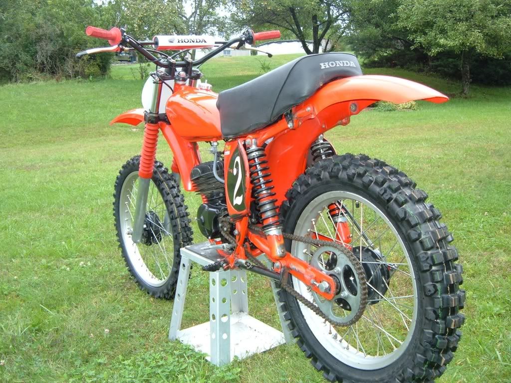

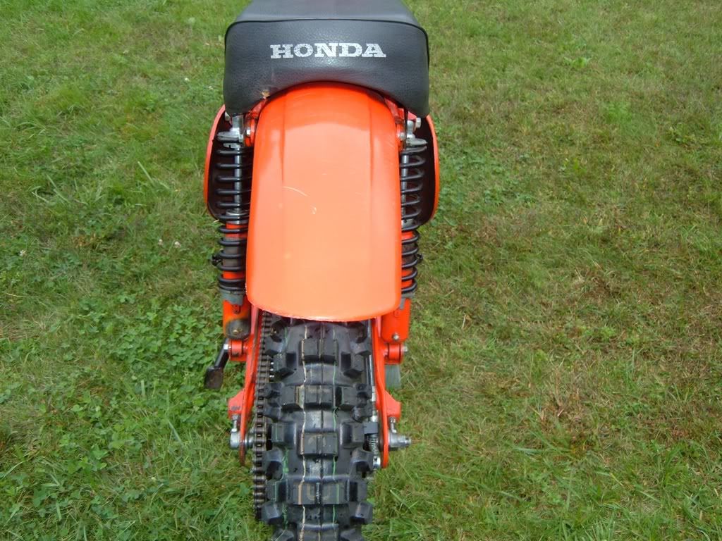

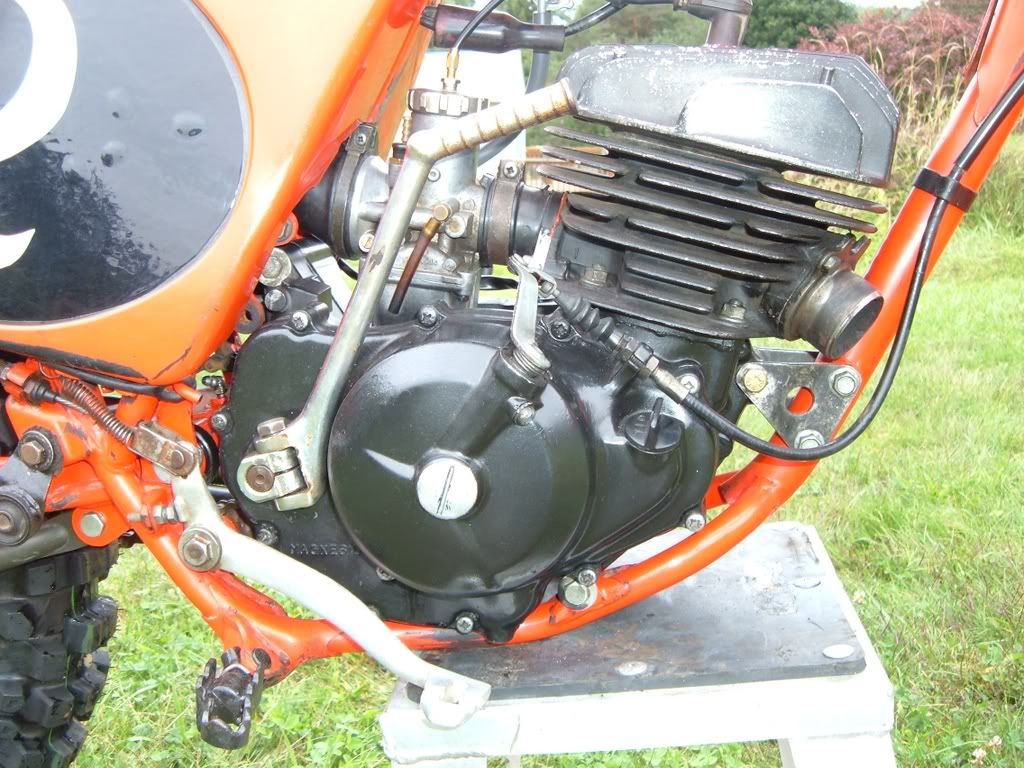

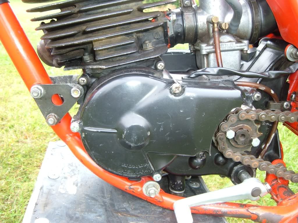

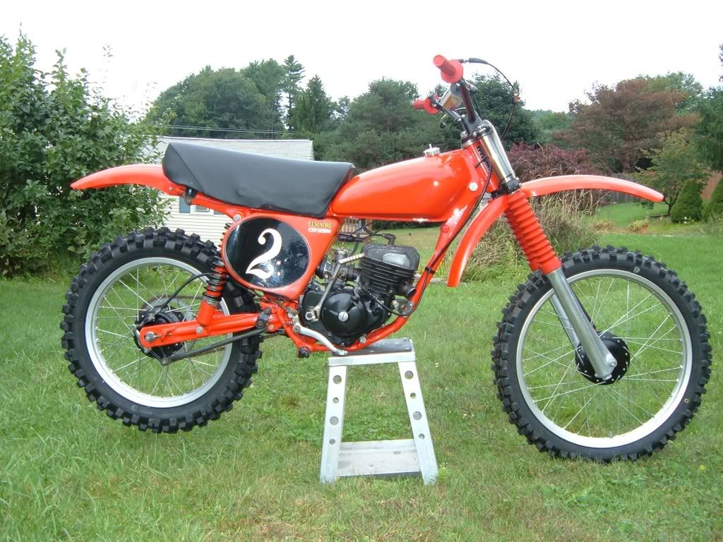

NEWS FLASH!!! Just got some nice pics from seller. Can anyone pick out good and bad, correct and not, buy or skip. Got a bottom line of $1300.

PostPosted: Mon Sep 15, 2008 10:07 am
From what I can see from the pictures, the bike is in OK shape superficially.
The ignition cover has been butchered (common problem) and it looks like
one of the screws is oversized which will necessitate a heli-coil or equivalent
case repair to correct. Also, at least one of the engine mounting bolts is a
"grab bag" so I would double check them all.
The right footpeg is tweaked, just make sure the mount isn't bent as well and it
looks like the forks are "pinched" down around the hub. Could be parallax from
the picture angle or could be missing a spacer.
Obviously, can't tell much about the mechanical side from pictures. If the bike
is local, get a compression test, check the kickstarter action, shift through the
gears, spin the front and rear wheels and listen for strange sounds, etc.
If the bike isn't local, cross your fingers.
Just remember, it is over 30 years old so all this is to be expected and I'm
sure there is more, but it looks like a pretty good start for a restoration.
