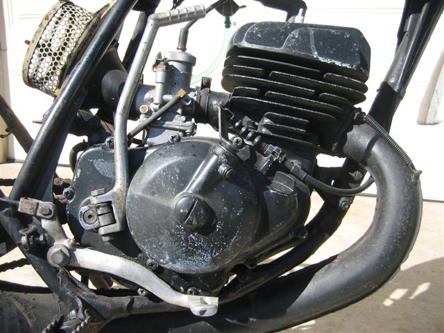

Thanks for the tips. I think the media blasting is out mostly because of the cost of the equipment. I have been looking at ultrasonic cleaners thinking it would pay for itself after 3-4 carb cleanings. My real concern was how well they work. Dogger, the carbs you restored are the results I am hoping to achieve. Did you send either of them out, or do them yourself. If so what type / brand of ultrasonic machine did you use. I checked online and prices are all over the place. I am thinking that a unit around $300.00 would suit my needs and budget? I am attaching a picture of what my carb looks like now. Will post an after shot if I achieve the desired results. Thanks again.
PostPosted: Thu Oct 30, 2008 7:31 pm
Joined: Wed Apr 09, 2008 11:16 pm
Posts: 14
Sorry about picture size. I will try to post better ones in the future!

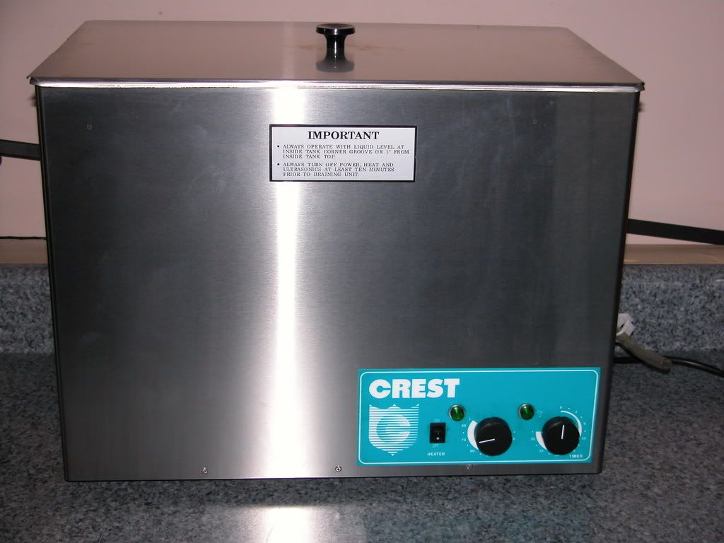

PACDESIGN, I do all my carb work myself. I tried sending a carb out for restoration a while back
and it didn't meet my standards when it was returned. The body had been media blasted right through
the anodization and was ruined. I had to pick up another carb and start over.
I use a Crest parts washer (I've posted a pic of it below), that is big enough (8 gal) to handle parts
like fork legs and engine cases. I use lots of different cleaners. For steel parts like tranny gears,
etc., I use Royal Purple parts wash mixed with distilled water. For aluminum parts I use Bransons
MC3 cleaner http://www.sonicsonline.com/mc3-metal-cleaner.html I have also used various Crest
chemicals as well as straight soap and water. The trick is using the right cleaner with the right
amount of heat for the correct amount of time.
In my opinion, there are three good reliable brands of sonic cleaners: Branson, L&R and Crest. I'm sure
there are other good ones as well. Just remember, like everything else, you get what you pay for
If you want a test run before investing in a unit for yourself, disassemble your carb and send me the body
(cap, upper and bowl) and I will sonically clean it using the MC3 and send it back. Don't worry about any
brass left on the body because it will clean that up as well. If you are going to restore other bikes, a
good sonic cleaner is a real handy tool to have.

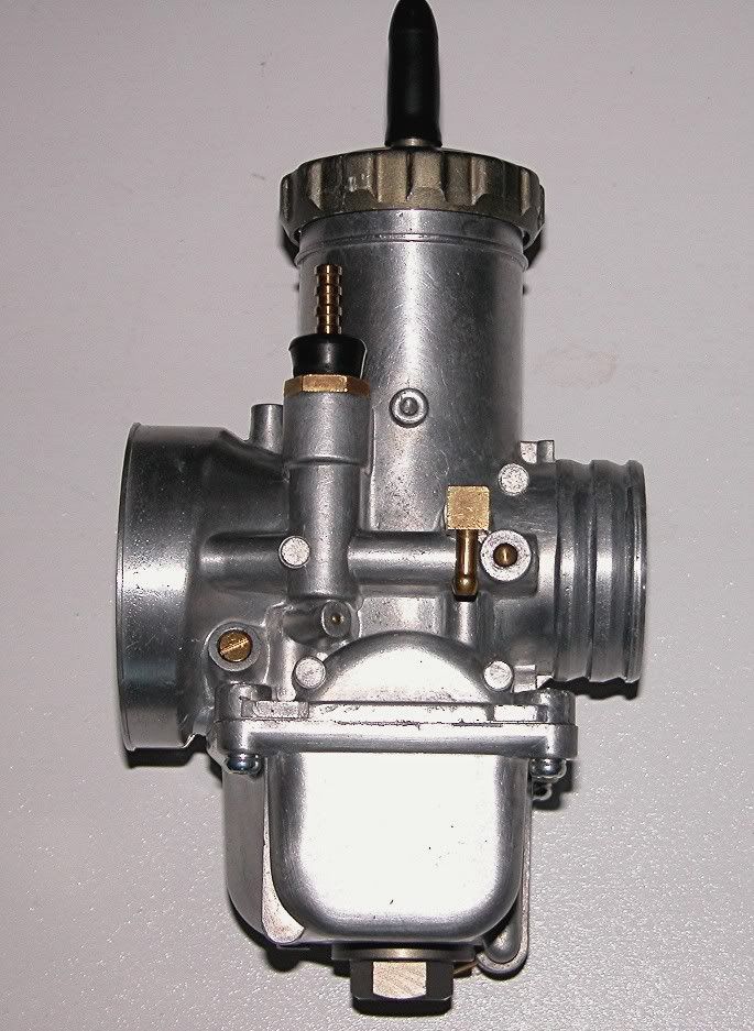

Sorry for the delay in posting the before and after pictures. Thanks again Dogger for cleaning my carb. As you can see it looks great. Thanks to everyone for the great advice. I will definately be investing in an ultrasonic cleaning machine in the next few weeks.
