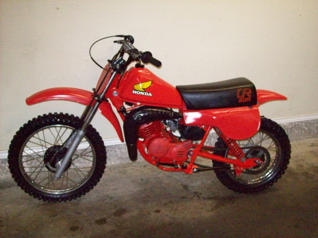

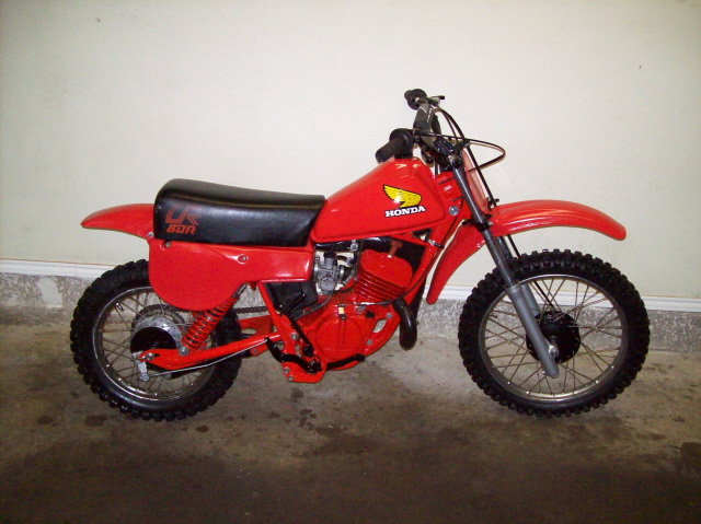

File comment: Before
File comment: After
File comment: After

bryank30 wrote:
If someone had the float height that would be very helpful :D
wow!!! that lokks super,any leads on plastic & getting bolts restored or replaced?thanks

Looks like you have the rear shocks 180 degrees off on your 2nd and 3rd pics. Just trying to help. Jim P.S. Good looking Elsinore.
