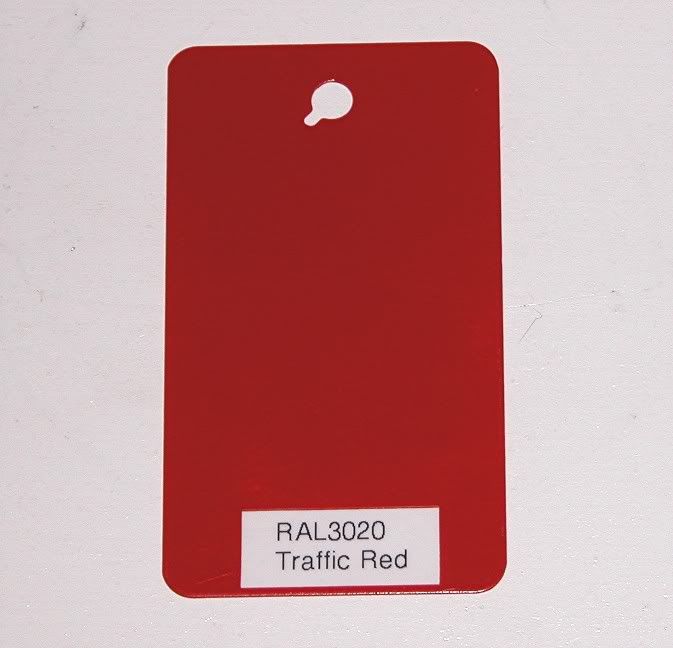

The reason the PPG and Dupont paint folks weren't very helpful is because neither
company stocks an RAL 3020 color paint. RAL colors are used extensively in other
countries, but are not readily available in the U.S., especially in automotive type
paint.
If you want to paint your bike with "Traffic Red" (RAL 3020), you can buy rattle
cans from this site http://www.aerosolexpress.com/shop/index.php?cPath=67
for about $4 a can plus international shipping.
If you want to use Dupont or PPG paint, you will need to get a color chip like
the one in the pic below and take it to the dealer of your choice and have it
color matched. Both companies have very sophisticated equipment that will
do that and print out the "recipe" using their paint. You can then use the
recipe to have paint mixed for a one or two stage process.
I recommend you visit your local powdercoat shop for an RAL 3020 chip, they
should have several and be glad to loan you one.
[imgImage][/img]
