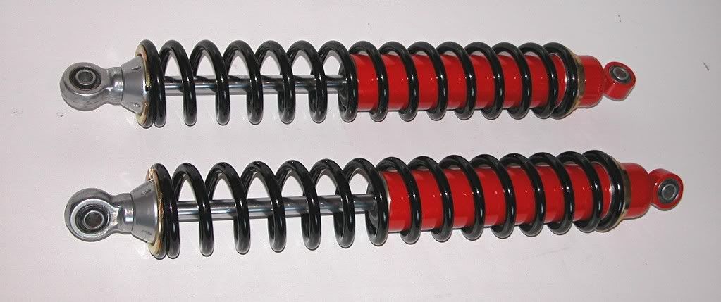

Below is a pic of the shocks I restored. The shock dampers were NOS but needed to be
repainted because of years of shelf wear. The springs were media blasted and powder coated
with gloss black powder. The spring seats were prepped and plated and the lower shock eyes
and cones were stripped, prepped and clear anodized. A lot of work and time but I think the
shocks looks and performs like they did when new ( no comments on how poor these shocks
performed when new).
