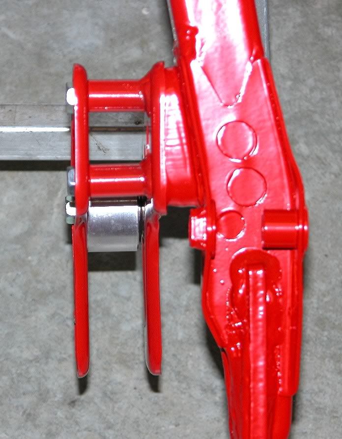

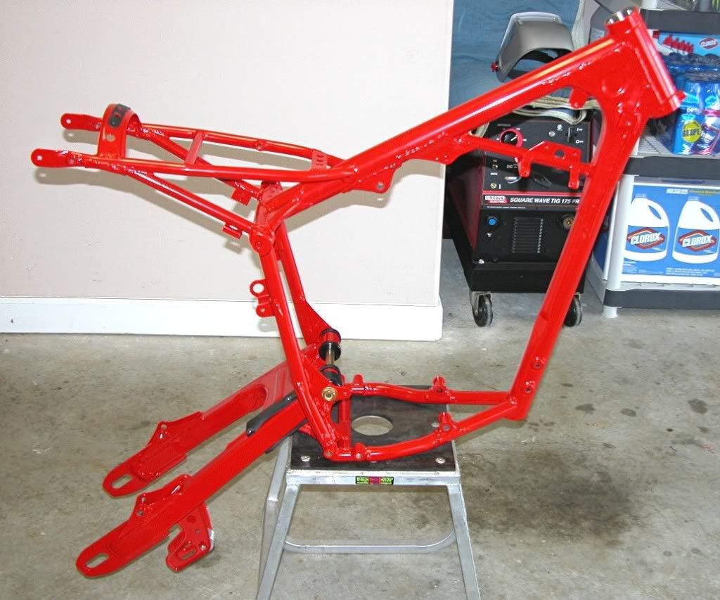

I just finished restoring the frame and swingarm on my '79 CR250.
I have plenty of finished parts to hang on it. Thought you might
like to see what it looks like before I "clutter it up" with components.
[img]Image[/img]
[img][Image/img]
[img][Image/img]
[img]Image[/img]
[img]Image[/img]

How do you handle the model plate attached to the headstock? I assume that it has to come off for the frame to be sprayed or powder-coated. I can understand that one can grind off the backs of the rivets inside the steerer tube, but then what do you use to re-attach the plate after paint? My race frame lost it's plate during powder-coating, but if I do another I'd like to get it just right.

PostPosted: Sat Dec 20, 2008 12:13 pm
Michael,
I don't remove the ID plates to paint or powder coat.
Before I media blasted this frame, I masked the plate with blue painters tape and a layer of metal tape
to protect it from the media. Before powder coating, I masked it with high temp silicon tape to protect
it from the powder and to withstand the curing (425 degrees) temperature.
Like you said, it is possible to remove the plate. But to reinstall it correctly, you would need solid rivets
and a specialty solid rivet gun. I was too chicken and didn't want to take a chance of screwing up the
plate while grinding off the old rivets.
