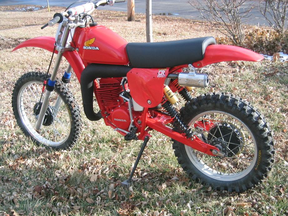

Nice job. Somone's got the CNC bug?
 Post subject: Re: 78' CR250R pics..
PostPosted: Mon Jan 05, 2009 6:58 pm
Joined: Mon Dec 08, 2008 9:48 am

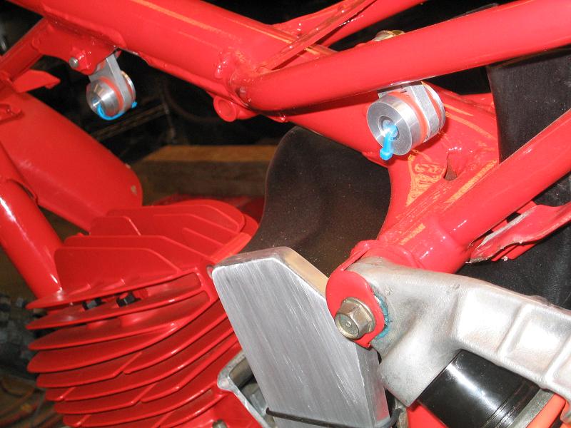

Actually the exhaust mounts and chainguide are done with a bandsaw, drillpress and a lathe..The airbox cover is formed with a wooden buck and a body hammer.... I'm lookin' for a mill...

I like your chain guide. I bought one similar from John Astleford i.e. the chain goes through a nylon block which protects the guide. I am amazed anyone runs the stock guides on a working bike.

Very nice work. I especially like the aluminum rear brake arm with the heim joints.
A lighter, stronger improvement over the damage prone stamped steel stocker.

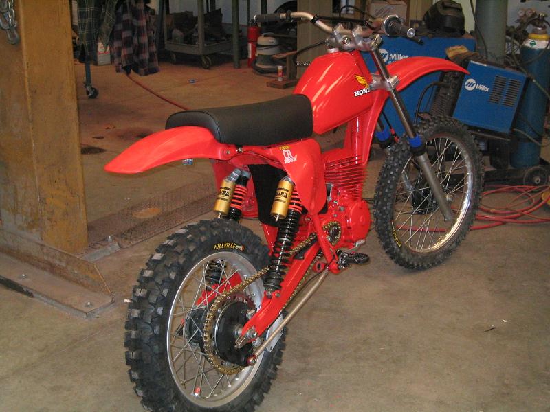

Nice !!! What shocks are you using?
