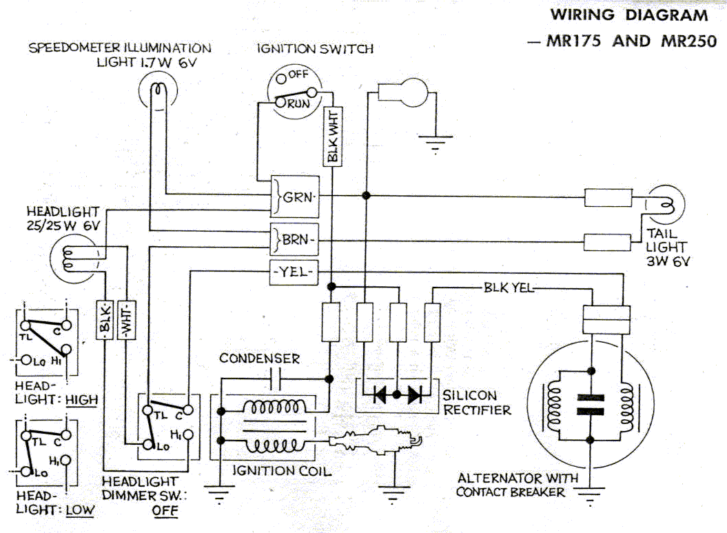

The lights have been removed so is there a simple diagram for chasing the wiring down to check it all out? I wanted to just have the essentials for starting it. For example, do I need the rectifier and condenser if I'm not using lights?

Here's a wiring diagram for your bike. I bypassed my rectifier and the bike ran fine, but the condensor will still be needed for the points ignition.

I haven't had a chance to make sure the pipe isn't blocked or check the compression. That's next when I get a day off...plus checking the points. I would love to put in a CDI and forget about the points, but I definitely don't want to spend a lot of money on this thing right now while I'm trying to get my roadracer ready for the season. You'd be amazed what a good electronic ignition will do for the performance. I don't know from this bike, but all my old brit bikes turned into new ones after putting a Boyer ignition in. And I got that plus an Accel coil in my race bike and it's a breeze to start and runs great.
I've been using NGK B8ES plugs but I'll try those others and see what happens. Another guy on here told me what jetting he uses for his Mikuni on the same bike, so I'll start there and see what happens. Not sure which slide though, I think the one I got has a 2.5 in it. I'll mess with that Keihin some more and put it on my other MR250 I'm fixing up to sell. I'm probably going to rebuild 2 engines all the way and put one in this bike I'm trying to get started, and one in the other to sell it. Thanks alot for the diagram! I figured it was pretty easy, but it's nice to have something to look at in case I get stumped.
