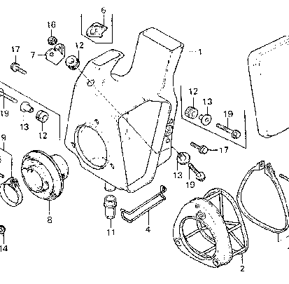

PostPosted: Sat Apr 25, 2009 9:06 am
Dogger - what airbox rubber bushings? - My airbox has the threaded inserts pop riveted to the airbox, is there a flat rubber washer between that and the frame mount?
The box is secured to the frame via three fender washers and collars (item numbers 12
and 13 in the diagram) and three 6X22 flange bolts and one 6mm flange nut. Two of
the fender washers mount on the frame itself and the third mounts in the hole on top
of the airbox. As the name implies, these are the same fender washers (and collars)
used on the front and rear fenders and the side panels.
[img]Image[/img]

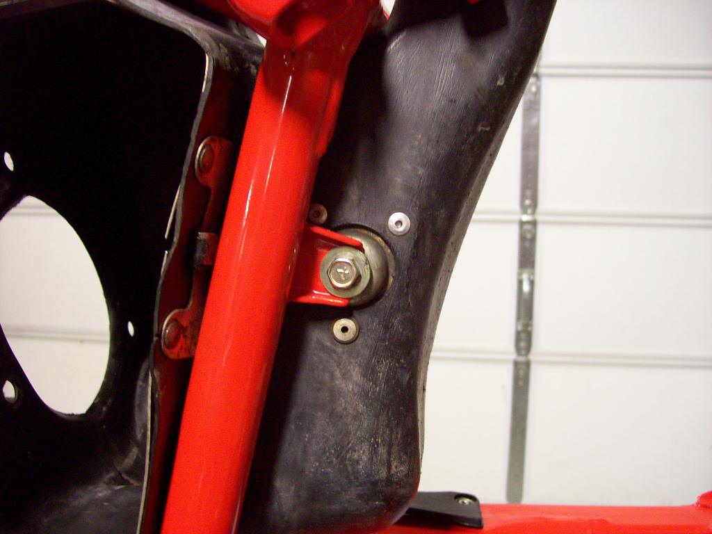

PostPosted: Sun Apr 26, 2009 7:47 pm
Joined: Sun Mar 30, 2008 5:53 pm
Posts: 26
My 78's have the grommet and washer set up, with a larger hole in the frame tab to hold the grommet. The fiche doesn't show any differences on the 80, then it came to me- the 80 was made in the USA factory, so they may have made them different, with only a 6.5 mm hole. I guess they just bolt up without any grommets.

PostPosted: Mon Apr 27, 2009 8:49 am
Interesting. I wonder how you are supposed to
buy parts if the fiche isn't accurate.

PostPosted: Mon Apr 27, 2009 1:59 pm
my parts catalogue for 78-80 model shows a difference between the models.
78-79 with gommets, collars and longer screws.
80 no gommets, washer and short screw.
