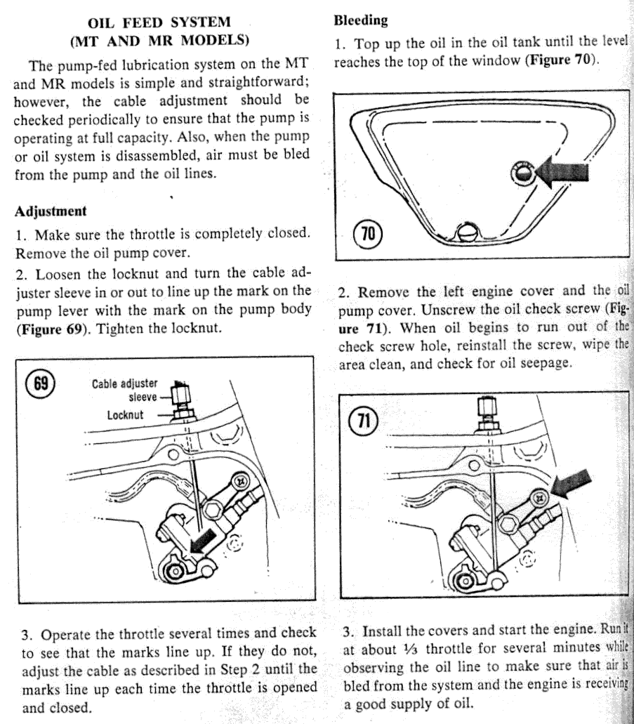

My buddy's MT250 still smokes a bit (bluish-white smoke), probably due to some misadjustment of the pump cable. At first fire-up after 15+ years idle it smoked a lot, but I was running 40:1 premix until I verifed the oil pump still worked.
Below is the oil pump diagram; figure 69 shows the adjustment marks.
