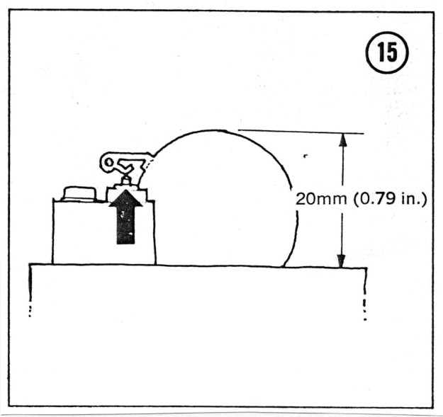

gas does not run out of the overflow when i turn the fuel on, but for a second or two a few drops will come out after i turn the gas on.
This sounds like a textbook case of a float level that's a lot higher (lower in mm - see diagram below) than the correct 20mm, but not quite high enough to overflow.

Here's a float level adjustment diagram:
