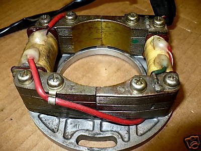

PostPosted: Fri May 15, 2009 6:49 pm
sounds like you have the wrong ignition in it.
Agreed - that's certainly a much more likely explanation than an incorrect factory diagram.
I've got three complete ignitions here (two '74's, and one '75) that are identical to the diagram I posted.
P.S. Below is a picture of a '74 CR125M stator assembly. Check out the black/red wire coming from the far end of the left coil, and the green and red/white wires coming from the right coil.

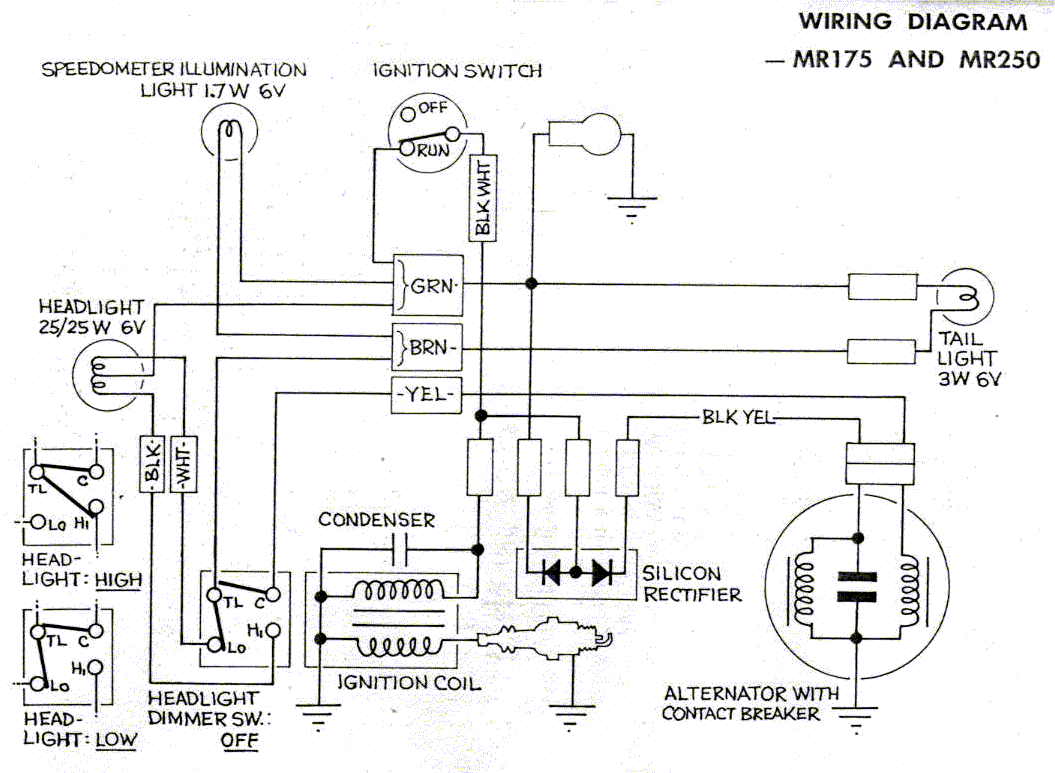

Here's another wiring diagram, definitely not for a 1974 Honda CR125:
I've got two MR175 ignitions here that match this diagram.
PostPosted: Sun May 17, 2009 8:47 am
Joined: Sat May 09, 2009 5:49 pm
hmm strange, in the cehicle registration it says cr125, and the engine hasnt been taken apart.... i DO have mr175 engines here, so unless someone modified it without my knowledge, its wrong.
im going to put the other magneto in and try that, thanks for all your help guys!
P.S. does this subforum also include TLs? i got one but am not sure it goes here for discussion...
