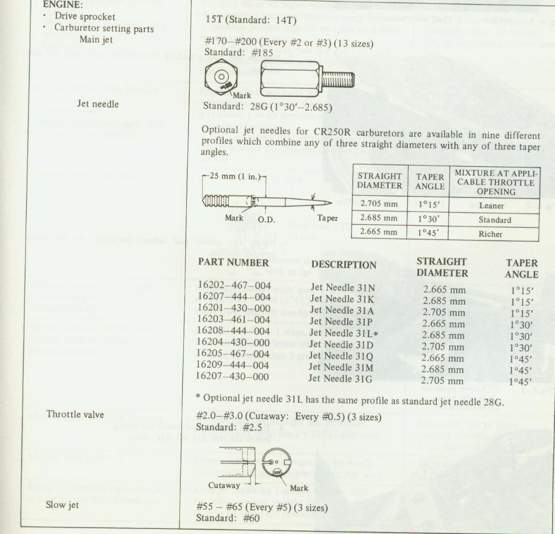

Thanks for all the info, I did find a 28D in my parts box, and it's running with that, but the 28D isn't on any of the charts I have. I'll try ordering from Sudco.
Is the needle the same for the '80 ?
Thx
Hans

from the 80´s manual
