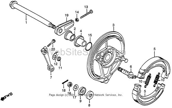

I am talking about the part honda refers to as brake panel bush not the pressed bronze bushing see item # 4 on schematic
PostPosted: Sat Dec 04, 2010 9:35 pm
honda calls this brake panel bush

Thanks! does this have a plastic cap also? looks like it has some kind of cap, Craig
No that cap is a thin metal dust cover that slides on the bush and sits on that lip then a thin O ring goes on.
I'm suprised the schematic number 4 shows it all as one item,when I changed mine I just slide off the cover and slide it onto the new one.
I don't have the dimensions for that unless I strip my rear wheel out.
 Post subject: Re: brake panel bushing
PostPosted: Sun Dec 05, 2010 3:09 pm
that cap must be similar to the dust caps on the brake stay arm correct?
Yes exactly the same style and probably the same thickness of material but made larger to suit.
