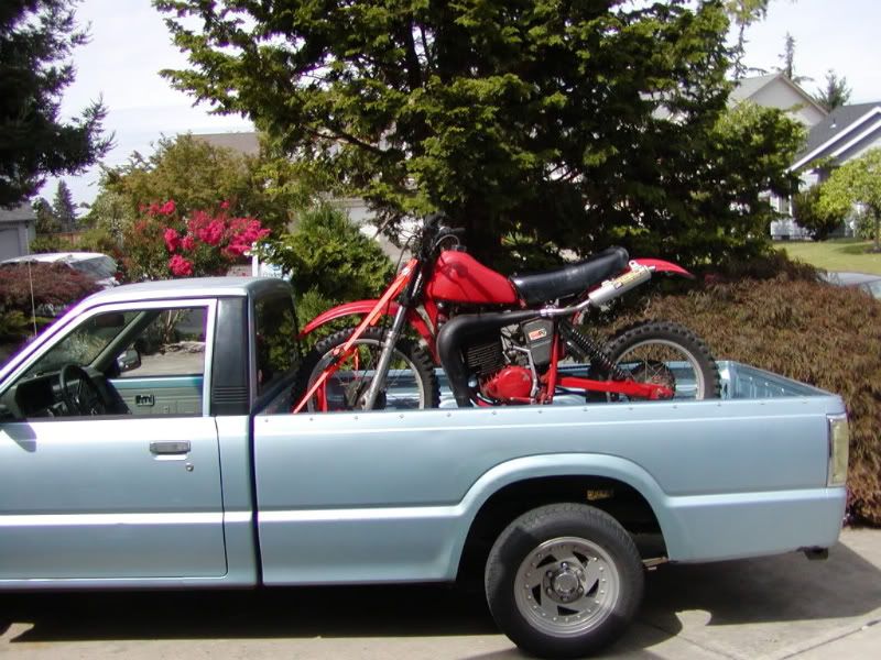

Just joined, thanks Nathan for the help with that, I have recently acquired a 1980 CR250R off of craigslist for $400 and it is going to be my winter break project, I got 3 weeks to burn :D Its in pretty good shape I think, the engine runs great, after sitting for a month I rolled it out of the shed opened the valve pulled the choke and it fired up in 1 kick, it has the expected worn out bits like the rear sprocket, fork seals, break shoes and chain rollers. I also had to get a new set of bars for it as the old ones are bent up. Here is a photo from when I brought it home, yes I got rid of the pro circuit muffler the first day, he had a super trap on it before but decided it was too loud and used bailing wire to put that thing on, I repacked the super trap and stuck it back on, sounds much better.
