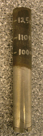

The shocks contained the following amounts of oil: 85cc, 90cc, 95cc, and 20cc as mentioned earlier. The OEM oil appeared to be graphite-based, apparently 5W. I initially filled the shock with 125cc of 3W Bel-Ray shock oil (I prefer light damping), but I wasn't comfortable with the oil level. Here's a picture of the shock cylinder, marked with the oil heights for various amounts of oil:
Judging by the oil line (top edge of the shiny metal), I'm assuming these shocks were originally filled with about 100cc of oil. With 125cc of oil, a sharp downward motion of the piston would completely fill the shock body with oil, over and above the top of the cylinder - which fits tightly against the bottom of the shock cap and cap O-ring seal. This had the potential to occasionally turn the shock into a hydraulic cylinder, which I really didn't want to do.
After some trial-and-error refilling and lots of oil on the benchtop :), I settled on 110cc, which just submerged the piston head at full extension, giving full damping while still leaving plenty of empty space in the shock body for hard-bottoming impacts.

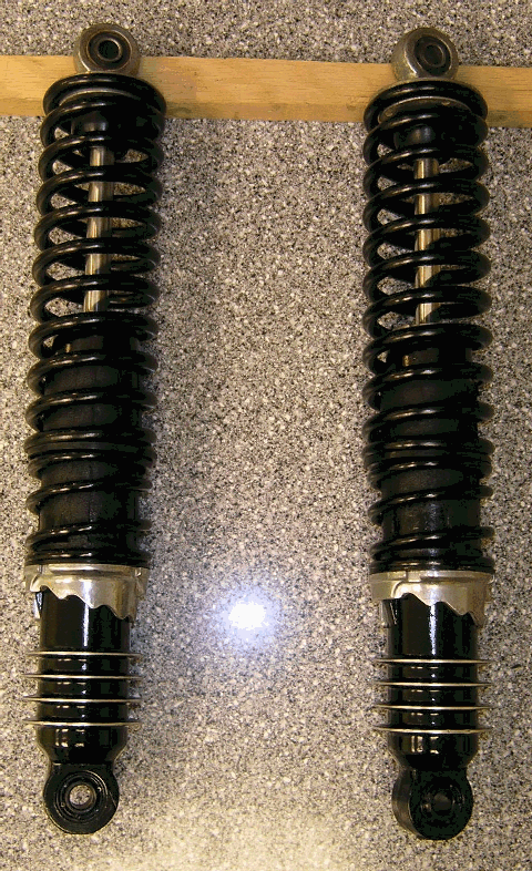

Below is a picture of the finished shocks. I wanted to try the black/aluminum look for a long time, and I think it came out OK.

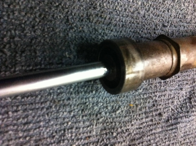

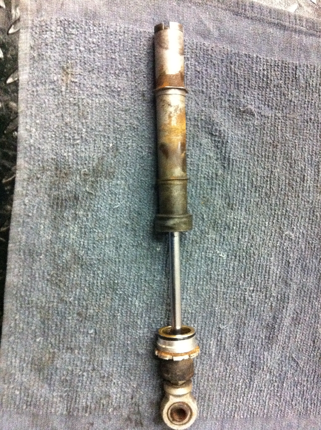

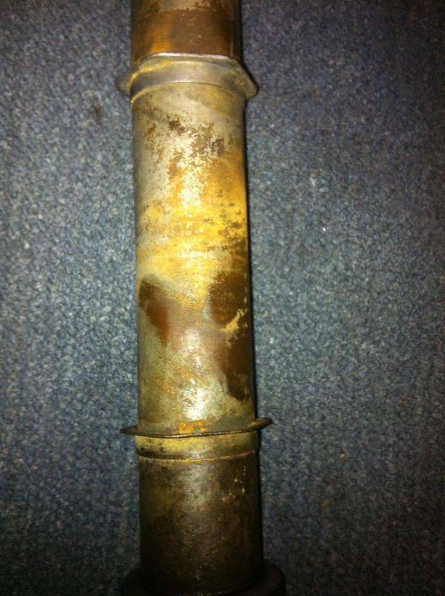

PostPosted: Sun Jan 29, 2012 5:03 pm
Joined: Sat Nov 26, 2011 2:12 pm
I have attached a few pictures of the valve body. From the pictures you can see the ribs that I was talking about in my earlier post. I know the eyelet and lock bolt need to come off.
I really need to know how the valving and the shaft come out.
Thanks again for your time and responding to my posts.
Paul

PostPosted: Sun Jan 29, 2012 6:00 pm
http://www.powersedge.com/pages/OemPart ... F13381111A
From the parts diagram, it appears the cylinder top cap (#8) is threaded and screws into the cylinder. This cap is smaller in the 360/381 series shocks, and is an unthreaded press fit. I don't believe the bottom cylinder cap is removable in either series, but I could be wrong.
PostPosted: Sun Jan 29, 2012 11:03 pm
Awesome, thanks for the link. That was very helpful. I'm amazed at the complexity of the shock valving components for that time.
