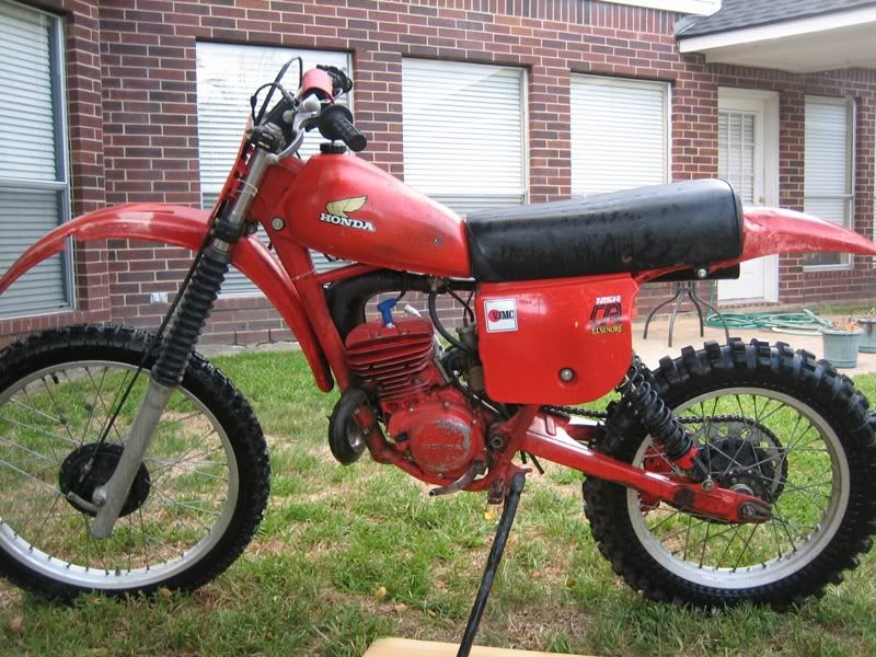

You got any pictures?
I have some before shots:

nice picture, looks just like mine did i have my engine apart now and the frame is ready for paint. just cleaned up the forks and put new seals in. i spoked the wheels my self its not realy that hard once you get the hang of it. search the web for (bucanon spoke) they can do your wheels real nice people there. i'm allso going to use an 80 rear swingarm and shocks for now. went to a 82 cr480 front brake with a 21 in. wheel. i allso went to a 19 in. rear wheel its not realy any taller do to the lower profile tire. just got my dunlop mx51 tires these look like there going to be awsome.

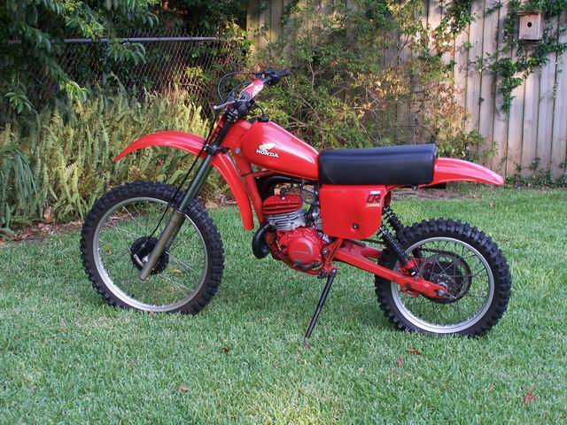

Here's mine. It has a fesh top end, replated cylinder, new mikuni vm 32mm round slide carb, new oil seals and seat cover. Runs like new and is a blast to ride, a real screamer!
