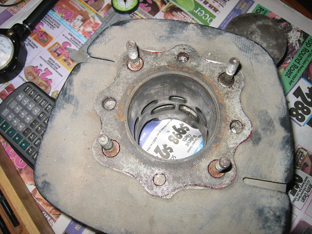

I measured the cylinder with my dads bore guage and it is about 0.007" to 0.010" bigger than the stock bore (70mm or 2.756") throughout the whole cylinder. I think the PO was honing it or something. The piston is also a little smaller that 2.756", I think it's around 2.752ish. This makes about .013" to .015" piston clearance. I think that is waaayyy to much, correct? What is it supposed to be?

Anyway now time for the stupid part :? . When I measured the cylinder before I had the micrometer set wrong, I had it set to 2.751 instead of 2.756. So I measured it again and now it is only .003 to .006" wore depending on where I measure it. I think that will be OK for standard bore even if it is out of spec a little. So now my questions are:

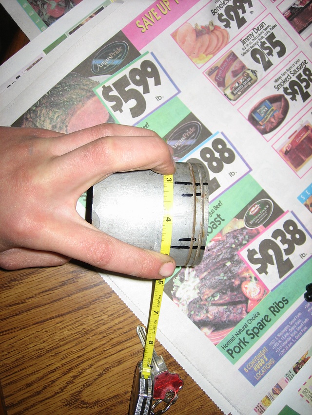

I also measured the piston again with the micrometer and it measured 2.744" at the bottom of the skirt. But then I checked the clearance with a feeler guage(attached pic) and and the 0.006" guage fit snug. I think that is good enough??

File comment: Piston Clearance.

File comment: Cylinder.

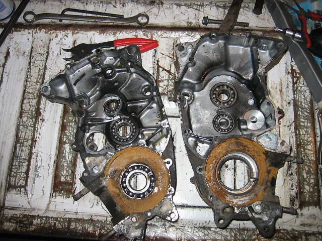

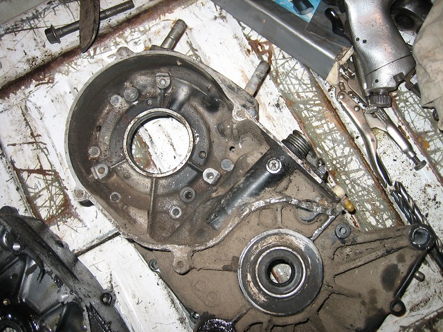

File comment: Here is the broken case.
File comment: Rusty Cases.

Attached are some pics and measurements of my piston and cylinder for reference.
File comment: distance between outside marks (inside edges of boost ports) is 1 5/8" and distance between inside marks (ring locating pins) is 1 1/8"
File comment: inner marks are the ring pins and the outer marks are the inside edges of the boost ports
File comment: here are the ring locating pins in relation to the boost ports.
File comment: measurement from the 2" to almost the 4" is 1 13/16"

Ring retaining pins: 1.26"/32mm apart (as measured on flexible ruler)
Skirt cutout height: 1.983"/50mm (not super critical)
Skirt height (max): 2.735"/69.5mm
Pin centerline to piston top edge: 1.27"/32.2mm
The retaining pins appear to be slightly farther apart than on the MR piston, possibly to clear the wider (?) CR boost port and allow this piston to be used on the CR/MR/MT/FL motors. I would suggest taking a measurement around the bore between the inner edges of the rear transfer ports, on each side of the boost port; if it's 36mm/1.42" or greater, you should be fine.
The wrist pins and small-end bearings have the same P/N's. so that's good.
The ART piston has a really cool machined surface (different from the OEM ART's I've seen) and should retain oil well even after a lot of use. It looks like a quality part, especially for the price.
