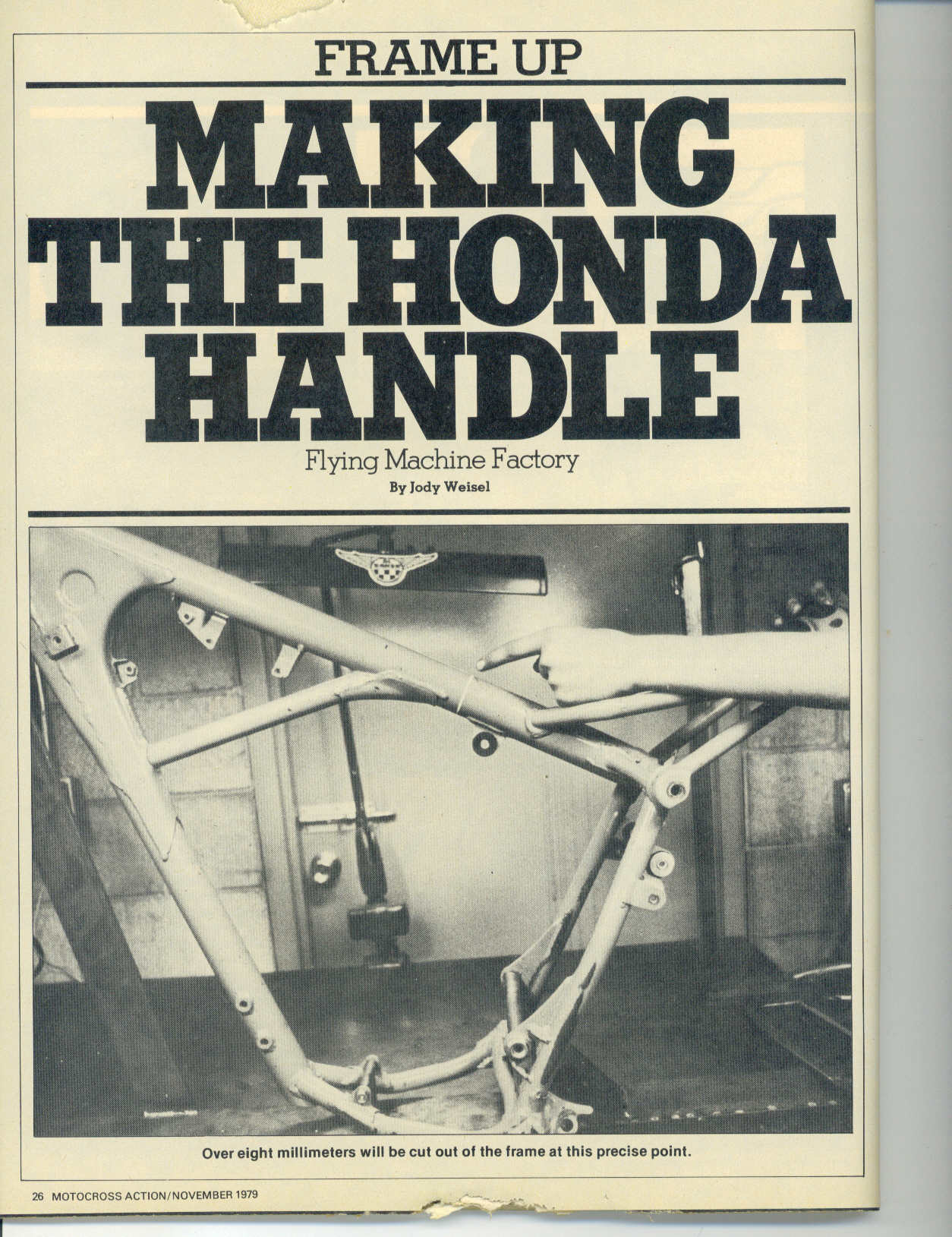

I found this, but it is not complete.

this is great keep the info comming. a least it shows were to cut the 8 mm out it should be easy. i work with a guy that use to race with some guys that raced these semi pro and pro. and he remembers cutting the frames and welding them but he couldn't remember how much. thanks nola_fiddy for taking the time to find this :D

No problem, I put out a request for the rest of the article. Hopfully someone will have it. At least we know it's in the nov 79 issue of Motocross Action.
Would love to see pics of a modified frame if anybody has them.

i think i will try the 8 mm the story said that they were going to cut more than 8mm out? but i'm going to look a 8mm and see what i will do. i remember reading an artical in a dirt bike mag about setting your rake and trail. and what each one did for your handling and how to adjust it that would be interresting about now :)

Cutting the 8mm out will move the rake out a little further forward of the bike. So with the smaller wheel, the tire should still hit the ground a relatively the same spot. If you get 16.5" - 16" rear shocks at the same time, you should get better handling, lower profile bike.
I'm looking at my stock 79 cr125 now and it certainly has a very unique (bizzare) stance. But that is what makes this bike special in a way. That said, I would rather ride the modified bike.
