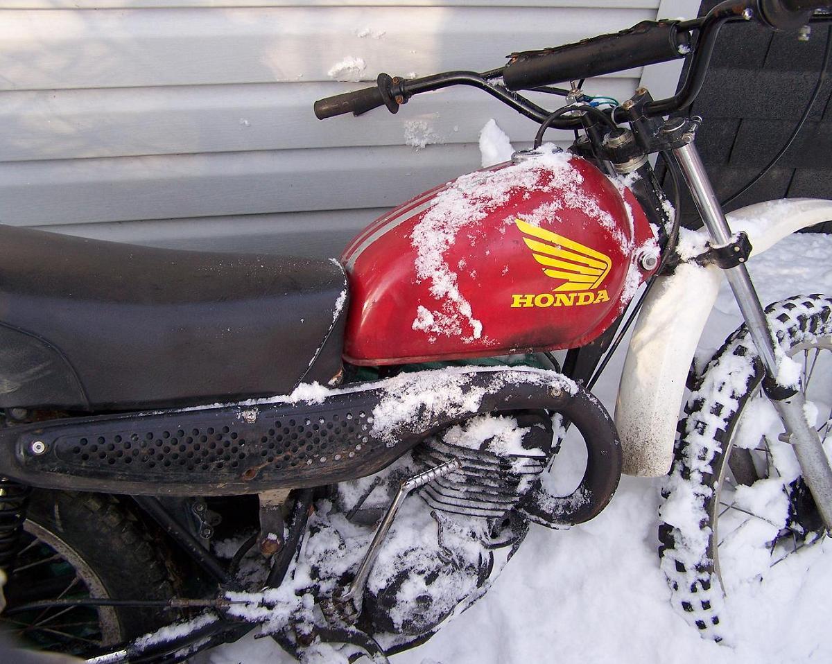

Hey guys,
First off I just want to let you know what has brought me here. Last fall I came across and old dirtbike i could not pass up. When I got it home I found out I am the pround owner of a 1976 MR175cc dirtbike.
So anyways When I got the bike it ran pritty well and was able to move under its own power. When I got it home I tried to start it but couldnt so i changed the plug which was pritty black looking. The bike fired right up... It would rev and idle all day in nutral but when I put it in gear and tried to get it going it seemed to bog out and not have much more than enought power to get me rolling without stalling. So I figured the carb was dirty so I cleaned that all up but same problem occured. So then I tried to ajust the carb float but didnt get to install it untill after the winter and now the bike will not run at all. I playe with the float some more so i think I set it back to noramal but I cant get this thing going.
I have tested the spark and got a nice strong blue spark.
I have just tested the compression which tested at 90-100psi! I think this means my rings and/or my piston is in need of repair. my repair manual is comming in the mail is 100psi to low?

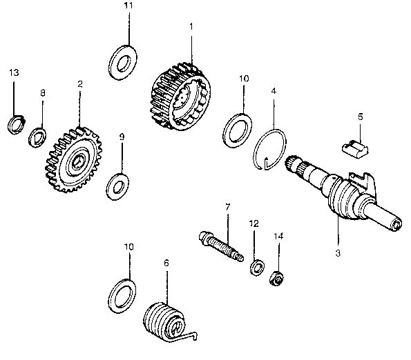

So I have run a few tests on this kick starter problem and it seems the spring is gone or broken because it does not want to return at all after the kick.
anyways I pulled the cover off and removed the kickstarter mech. and I do see a spring but its deep in there and it is to large to get out of the hole its in. Is this the return spring? and how would I reset it? I will take a few pictures tonight and get them up to better describe it.

If your kickstarter return spring is broken, I'm afraid that's bad news. With the kickstart gear/pawl/etc. removed, can you can easily turn the kickstart shaft in either direction by hand? If so, the spring is broken.
This spring (item 6 in the drawing below) is inside the main engine cases, with the transmission. To get to it, you basically have to disassemble the motor. I've been looking for a new one of these springs for almost two years - they're extremely rare.
If you want to get your bike running for a reasonable amount of money in a fairly short time, what I would suggest is to pull the clutch off (I would take the opportunity to replace the clutch plates with new OEM ones and use Barnett 501-29-06072 springs), remove the kickstart idler gear (item 2 in the drawing) and then reinstall the clutch and side cover, leaving the kickstart lever off.
The kickstarter will no longer work, but the kickstart shaft (item 3) should retain one half of the broken spring, with the other half retained by the engine case - so the broken spring should not be flopping around inside the transmission. Since the idler gear is gone, it really doesn't matter whether the kickstarter pawl engages or not, since it will only be engaging the stationary gear on the shaft (item 1). The shaft will also serve to seal the hole in the engine cover.
I know it's not an ideal fix, but for what it's worth I ran my CR with no kickstart lever (as a weightsaving measure) for at least 12 years, and the only time I use my MR's kickstarter these days is if I stall in tight woods.
