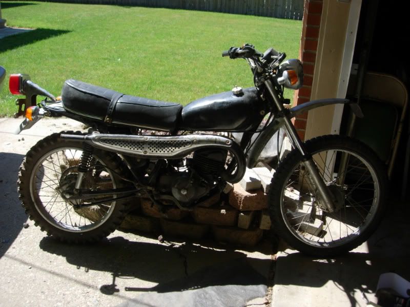

so I bought a $80 first bike...
it's missing almost every mechanical control so I figured this is where I would ask questions
now my first task is JUST MAKE IT RUN! I got lucky and the engine has compression and the carb doesnt look too bad.
I ordered a carb off ebay for a 93-94 CB just to get the throttle parts that go in the carb and the twist grip.
so here's the first question. will a throttle cable from a NSR125 work? as I figure you have to pull the oil pump and the throttle at the same time. here's the ebay link http://cgi.ebay.com/ws/eBayISAPI.dll?Vi ... K:MEWAX:IT item number: 350349519476
I'll have more questions as the build progresses so I thank all of you in advance, NOW SOME PICTURES of what $80 of can return money can buy

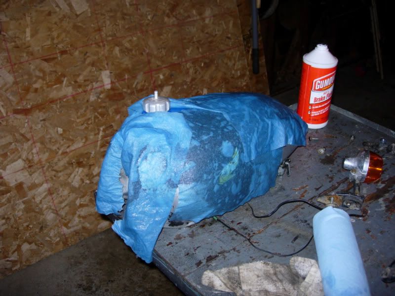

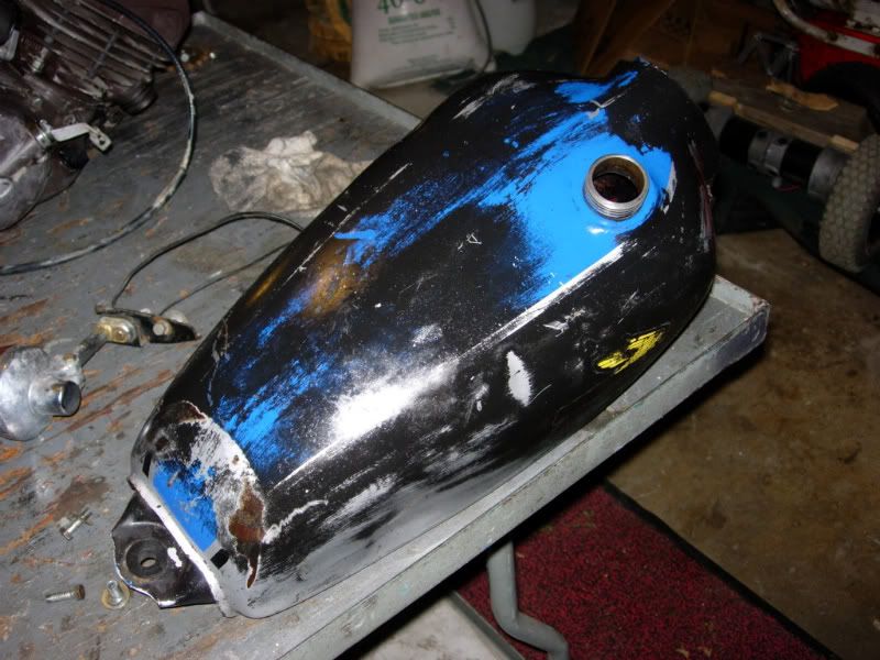

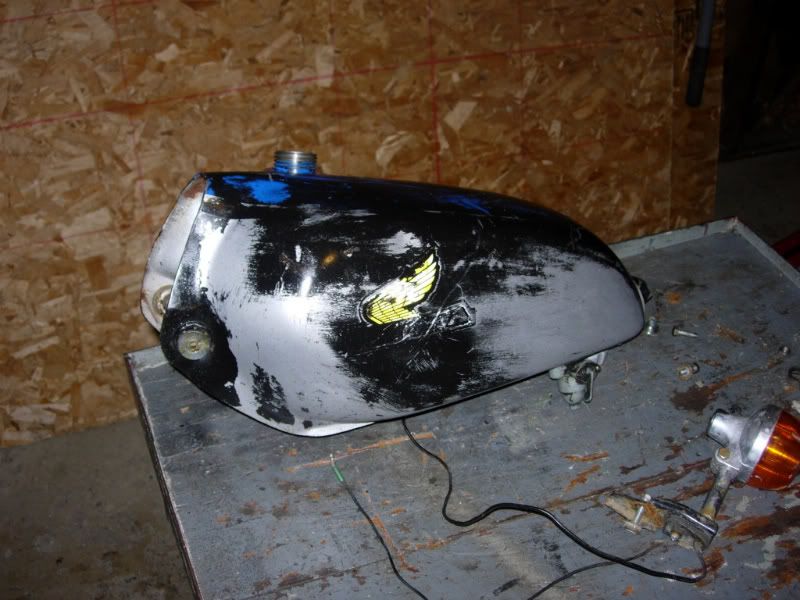

a couple coatings of brake fluid later
you can start to see the 1973 colors!
here's how I coated it, I ragged on some brake fluid then soaked some disposable rags and put them on the tank to sit for a few hours

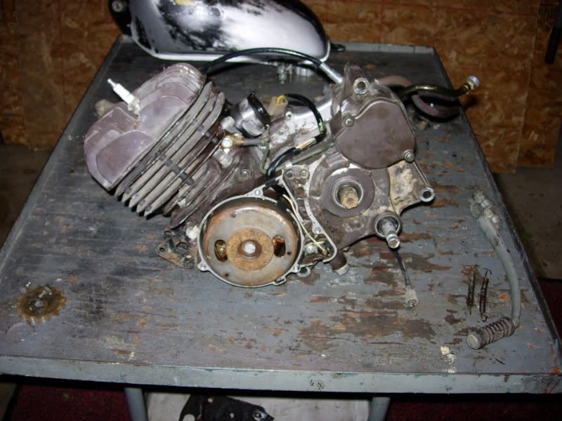

and here's tomorrow project, check the points and oil pump and make sure the engine is ready to go back in

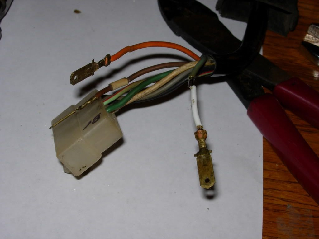

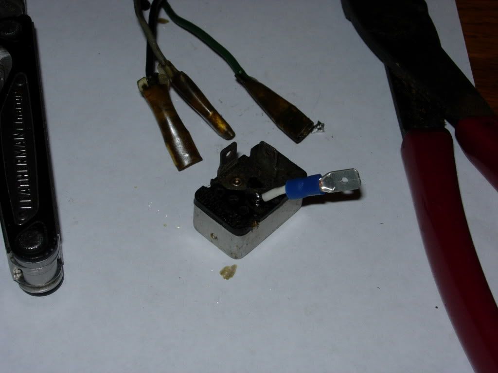

re wired the blinker relay and front headlight plug
notice how I did it so it should look as factory as possible yet keep my costs down. I'll rewrap most of the harness in new tape because some of the original tape is aged, and I still need to find some heat shrink to cover some cracked insulation and my splice to the front headlight

got the ignition coil and condenser and shift pedal in today...
put the motor and wiring back on the chassis. no luck on spark yet. also the suzuki kick pedal isnt working out, so I'm gunna have to splurge on the right one and sell this one.
